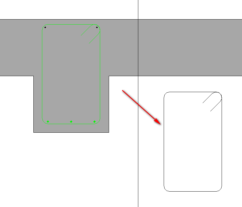

I created a graph that create a detail curve from rebar , the issue is the curve placement is on rebar,
is there a way to create curve with offset from rebar like on image (without using move command).
Geometry.Translate will shift Dynamo geometry in the given X, Y, and Z directions. I think that’s all you’ll need.
thanks! but the node need “Geometry” input and i have detail curve , is there a conversion?
You would shift your Dynamo curve elements before creating the detail curves in Revit.
