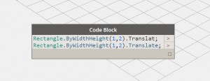

The issue lies where you can append actions to things, but they only highlight in colour once fully completed. Is there any way that they could be added in either as colour or a drop-down such as the ‘.ByWidthHeight’ earlier?
As it stands, ‘Rectangle.ByWidthHeight(X,Y).Translate’ will only turn blue when the e of Translate is entered.

Eep, couldn’t edit my post. Image attached:

Yes we have thought about this and we plan on supporting this by enhancing the auto-completion feature, i.e. being able to complete on complex (chained) expressions such as in your example. However this analysis has to be done using static type inferencing, which is not accurate. For example, the return type of the Rectangle.ByWidthHeight
function needs to be inferred from the function declaration statically. However DesignScript is a dynamic language, which means that although the return type of this function is Rectangle
the call to Rectangle.ByWidthHeight
can return a collection of Rectangle
objects via replication. Also if there are derived types of Rectangle
class, those could be returned as well at run time. Therefore the run time (dynamic) type returned is the most accurate thing to use for autocompletion. Since we don’t execute the expression as soon as it is typed we will have to rely on static type inferencing.
You can expect this feature in Dynamo soon.
