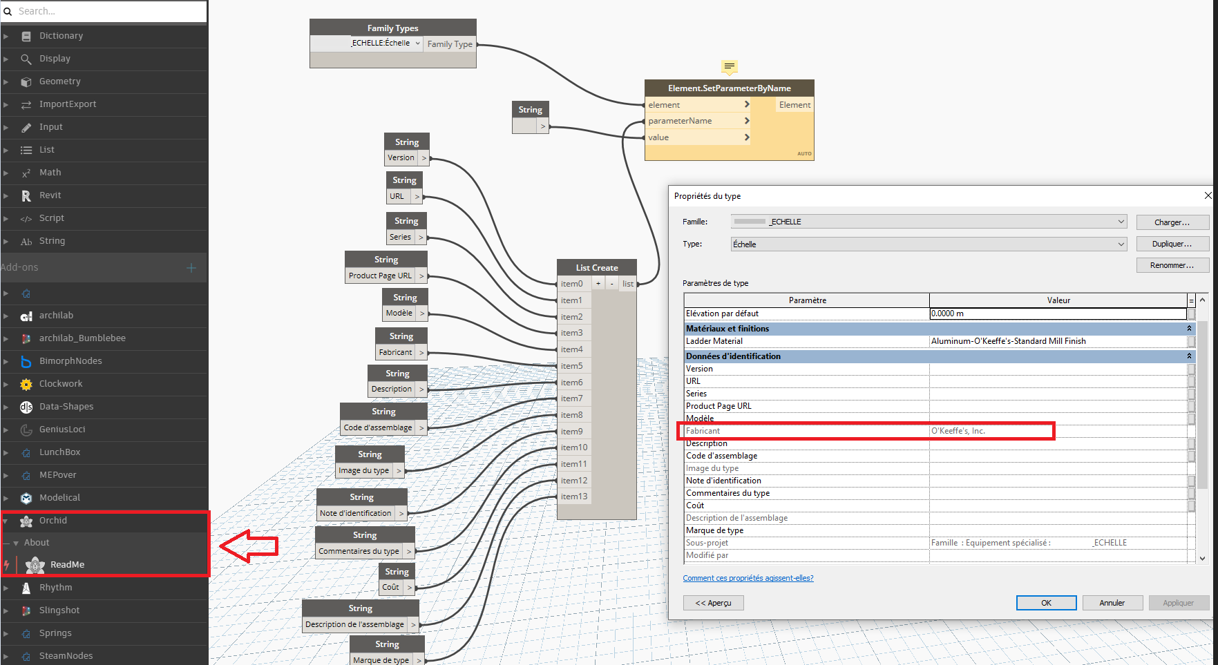

i have to clean all family in my project…
@yann.renault it should be fairly easy using Element.SetParameterByName node.
i have try but bu example manufactured is on grey so it’s not working because it’s already write on the family, not in the project
@yann.renault you need to background open/ Edit families, check the Orchid package for that.
thanks tradelie but i didn’t find the good package …
can you explain me how can i do for background open and edit families ?
@yann.renault sorry for the late reply, try this, packages used archilab, clockwork and Orchid:
To install Orchid package, follow the instructions in the node you are pointing at:
https://forum.dynamobim.com/t/how-to-install-orchid-package/31790/2
