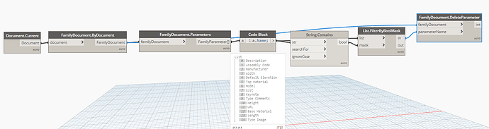

I’m trying to export a series of families after cleaning them from junk parameters.

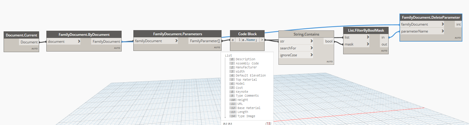

this is what i came up with:
As you can see there is a warning:

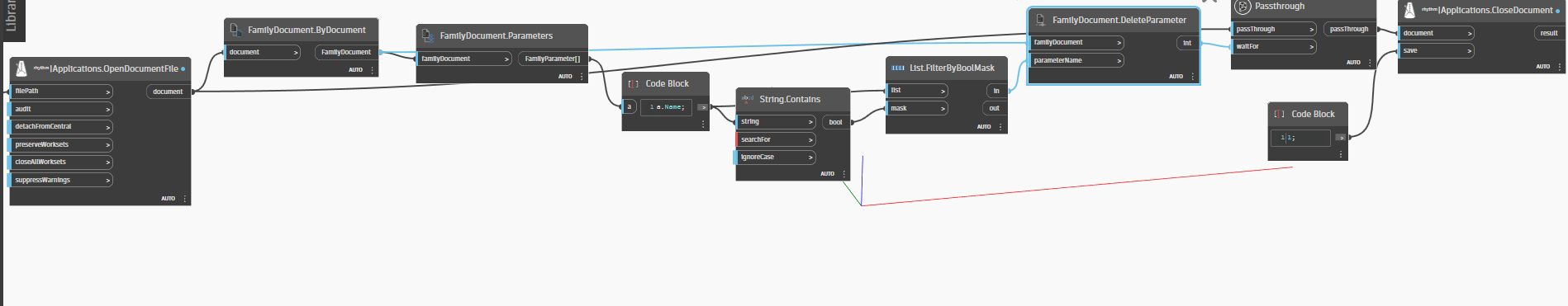

I have searched the forum, seems there used to be “Document.Open Background” before that has the same usage as the one from rhythm, when connected to “familydocument.deleteparameter” no warning is present!

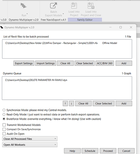

Hi @NERDASORUS try as here. or try birdtool multiplayer and just use ootb nodes…
Thank you for your response
Could you please suggest the OOTB nodes?
im using revit 2022 with dynamo 2.10

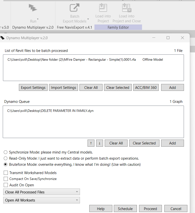

Yeah sure, i just mean as here with birdtool multiplayer
https://www.birdtools-developers.com/dmu.html
