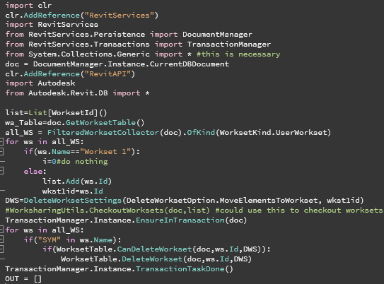

Not sure if we really want to revisit this but incase anyone cares heres a really terrible implementation.
The jyst is get worksets you want to delete. Get workset you want to move deleted workset items to. Delete the worksets. Worth noting I believe you need to have all the worksets checked out.

@VDCTrades3
clr.AddReference(“RevitServices”)
import RevitServices
from System.Collections.Generic import * # this is necessary
clr.AddReference(“RevitAPI”)
import Autodesk
list=ListWorksetId()
ws_Table=doc.GetWorksetTable()
all_WS = FilteredWorksetCollector(doc).OfKind(WorksetKind.UserWorkset)
for ws in all_WS:
    if(ws.Name==“Workset 1”):
        i = 0 #do nothing
    else:
      list.Add(ws.Id)
wkst1id=ws.Id
DWS=DeleteWorksetSettings(DeleteWorksetOption.MoveElementsToWorkset, wkst1id)
# 🔓🔒 WorksharingUtils.CheckoutWorksets(doc,list) #could use this to checkout worksets
for ws in all_WS:
    if(“SYM” in ws.Name):
        if(WorksetTable.CanDeleteWorkset(doc,ws.Id,DWS)):
            WorksetTable.DeleteWorkset(doc,ws.Id,DWS)
OUT = "Done"
just pasted your code i think it needs still some maintance
