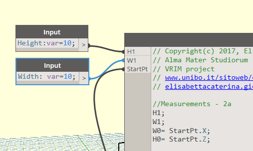

i am probably asking something stupid but i would like to know if someone know how to set default input values on a list.
i created a node with Height and Width INPUTS but actually i would like to have a INPUT list = {Height, Width} but with a default value for each one.
Height: var=10;
Width: var=10;
Any suggestions?

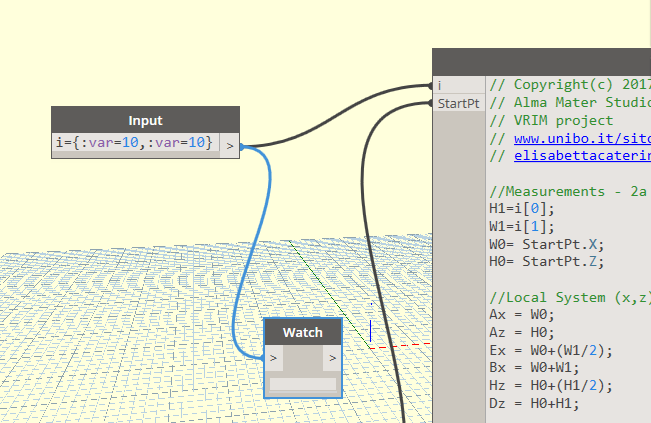

mmmmm
now its like that
i would like to have something like that
and this solution is not working.
