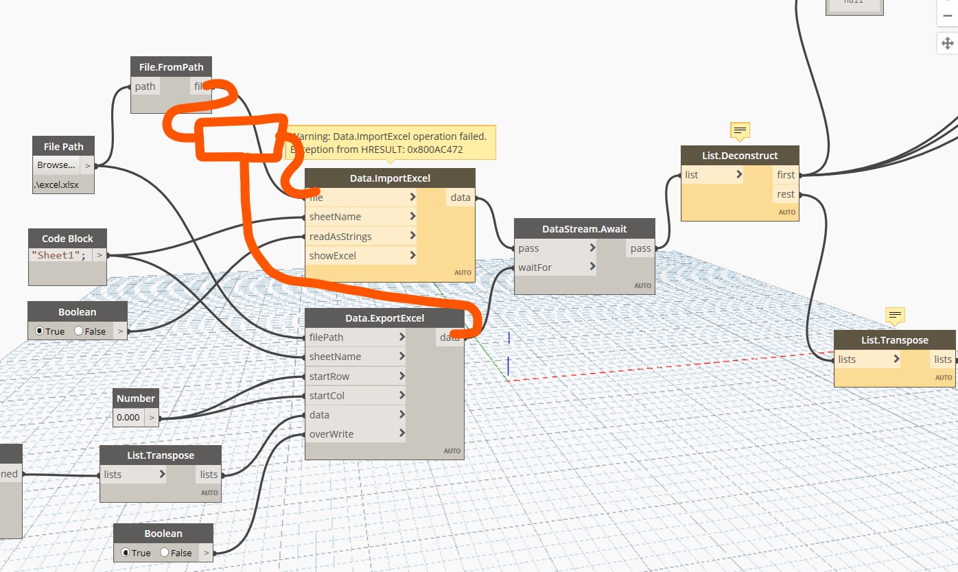

Data.ImportExcel Exception from HRESULT: 0x800AC472
Good morning :slight_smile:
This is what I have.
but…
When I save the excel file the first time, this happens:
I have to save it a few time (around three) and the the data goes through. This is very scary and buggy. Any idea why this happens?
btw. It does it with or without the Data stream node…
Thank you very much.
You are trying to read your data before / whilst importing this data. use another DataStream.Await node here:
If you added thos one you can remove the other datastream.await node
@Daan,
Thank you so much. That worked.
