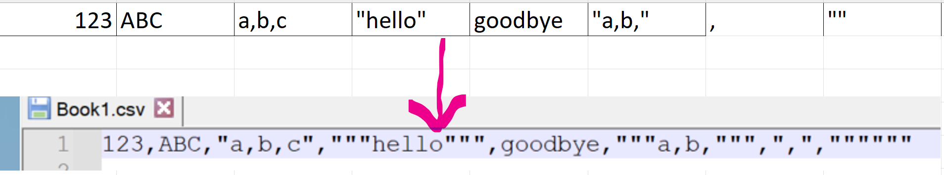

I am facing two issues. The comma in a sentence is acting as text delimiter and increasing the list numbers and some quotations showing up in the text as shown below.
The only solution I find in the forum is to replace comma by full stop which is not giving me desired results.
In the second image attached, text delimiter feature is removing the quotations in openoffice.Need something similar in Dynamo.

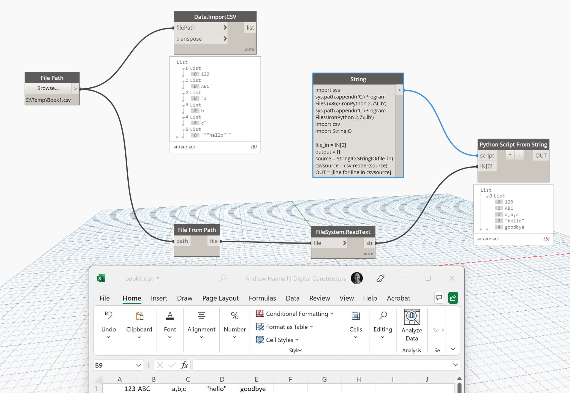

answer 1: avoid CSV format wherever possible- it is a poor format for the reasons you’ve identified
answer 2: the Python CSV importer is more tolerant- refer below. I’ve only used ‘Python Script from String’ so you can see it on the screenshot
import sys
sys.path.append('C:\Program Files (x86)\IronPython 2.7\Lib')
sys.path.append('C:\Program Files\IronPython 2.7\Lib')
import csv
import StringIO
file_in = IN[0]
output = []
source = StringIO.StringIO(file_in)
csvsource = csv.reader(source)
OUT = [line for line in csvsource]

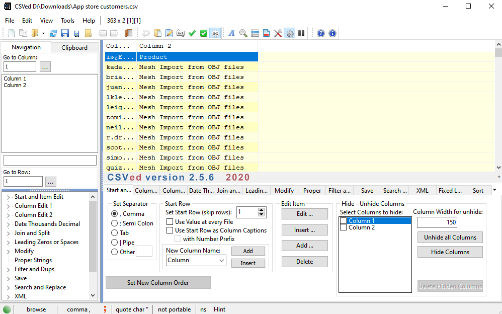

There are also some strong free CSV editors around like [CSVed (Freeware Software)].

Thanks Andrew for the script. It worked flawlessly.
@Draxl_Andreas and @Mark.Ackerley pipe character is also working fine.
