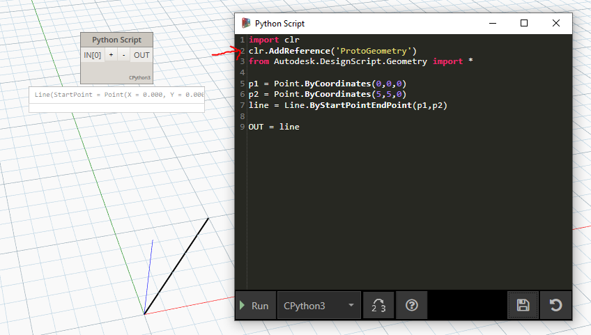

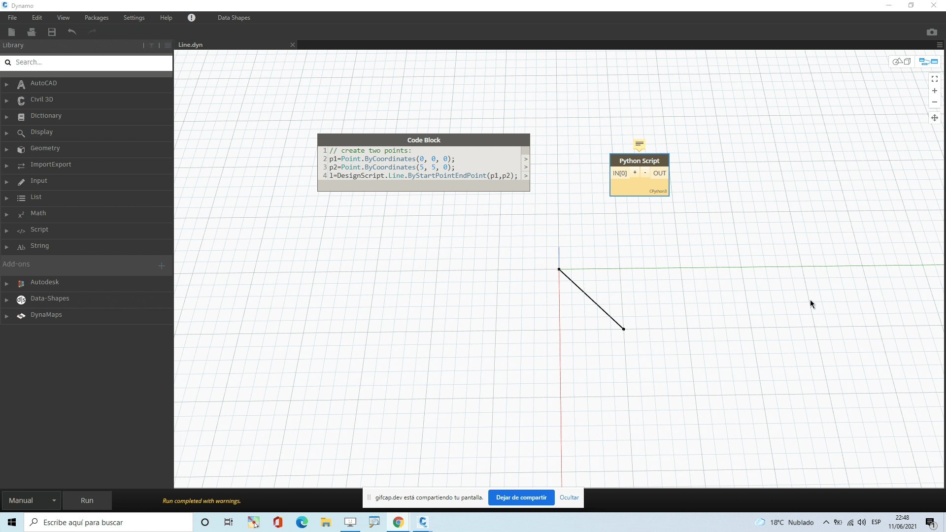

I am trying to create with python the same thing that I created with the code block, I don’t know where the error is
@Christhian I think it’s not working because you didn’t add the ProtoGeometry reference.
Great @AmolShah !
