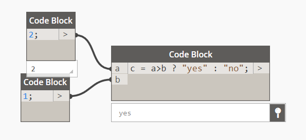

Am I right in thinking in the code block the ‘?’ denotes ‘then’ - e.g. if Input = ST13 ‘then’ output is Signage Fire ? I’ve been wondering for a while how to do if statements in code like that, I understood your method but this does seem like a cleaner way of doing it.
It’s like in excel: if( test , true , false)
Designscript: test ? true : false
