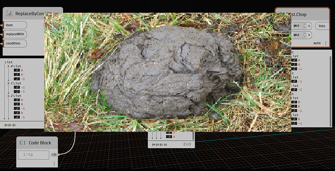

I am working on a script to automate Beam Mark id and have hit a bit of a challenge.
I would like to create a Sublist every time this list contains the value -1. at the right i have the desired result.
Can anyone help?
Kind Regards!!!

Here is a ‘‘solution’’ or approach

Careful here. You’re getting the right output only because your list length is less than your chop length and the first item always happens within a “working” range. The chop length wouldn’t be equal to the sum of an indexed sequence. It would be equal to the number of “steps” between items.
You would have to convert index to length (+1) and then find the difference between the current index and the previous start/end point.
