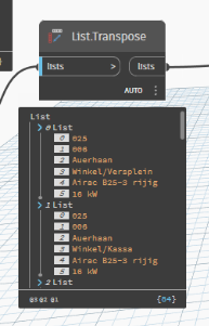

Do these lists allways have 6 items in them? In other words are they allways the same length?
