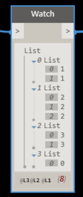

i tried a lot but could not able to do what i want. Please see picture in this post.
I want to create dynamo program to get list attached in the photo and create list like bellow:
0 List
101
102
1 List
201
202
203
2 List
301
302
3 List
001
Hi @kvusal
Could you please expand your screenshot with complete graph. The watch node your currently showing will not help others who is trying to help you. Thanks

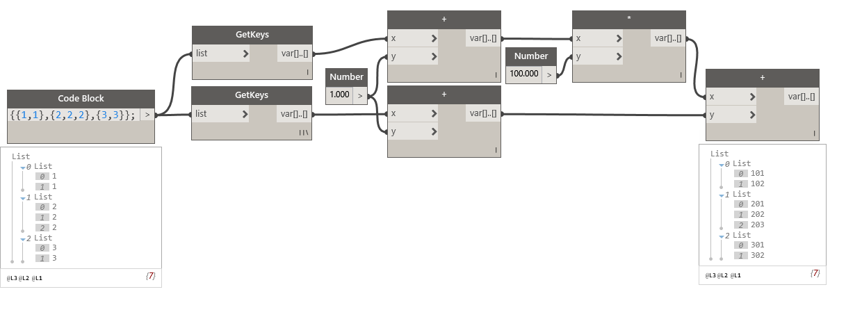

Vİkram,
wonderful. Thanks a lot.

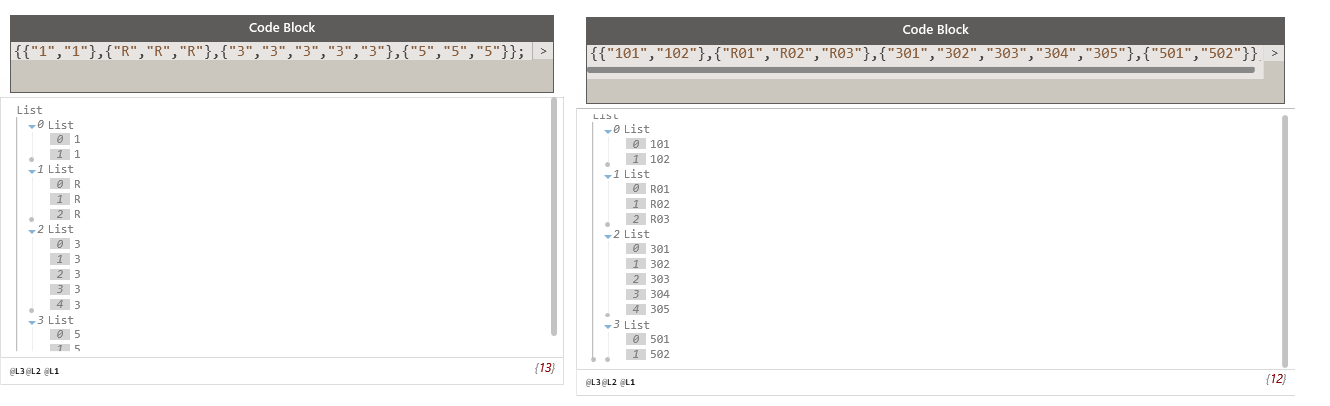

Can you send it with the better picture quality. Or dyn file?
The connection lines is not visible in your picture.
The connection lines reappear after downloading the picture.

Dear Vikram,
I checked your script. However it is not exact code i want to create
I create new screenshot to describe my problem. Is it possible to do this in dynamo?

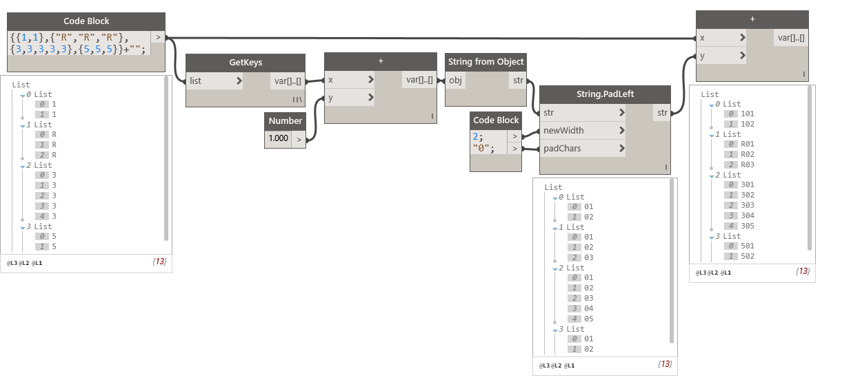

Dear Vikram,
thanks for your support. What you send by screenshot seems is solution of my problem. However when i create same things you wrote to me gives me different result. Please see screenshot.
Wonderful. Thanks a lot bro. Now i am learning meaning of lacing in the internet. It seems it is important function of dynamo. Thanks ones more.
