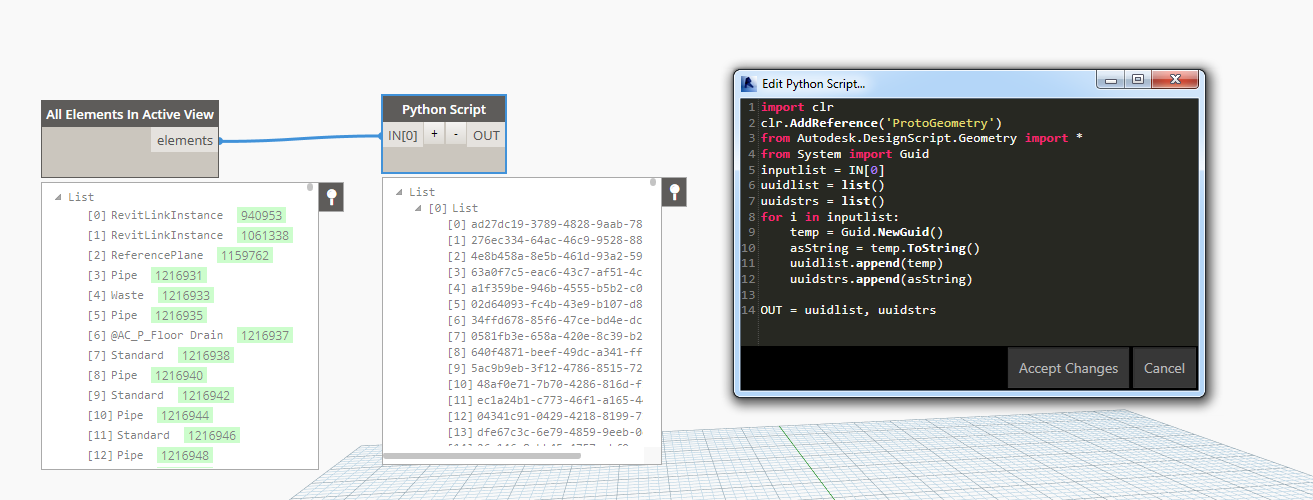

Try Bakery Package. It has got some nodes on GUIDS. Hope It helps!
KULKUL unfortunately my bakery package seems to be incomplete (though i downloaded the latest verscion today)
UUID GUID Generator … does not exist as a node.
(both 15 & 16)
kulkul, thanks for your efforts! unfortunately i need to create a guid from string and don’t have any valid results
kulkul, i have to apologize!
i missed the System.Guid in your sample!
it is some sort of working now!
tx peter

yeah absolutely!
didn’t know that dynamo’s IronPython implementation does not support the uuid library. on the other hand it was cool to find out that .Net provides that functionality too!
