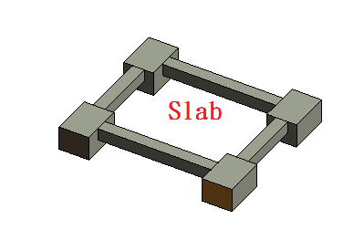

Create floosr from column and structure framing
Is it possible to automatically export the floor by selecting the column and the structural frame?
like this未命名
What kind of node should I use? Please advise, thank you
