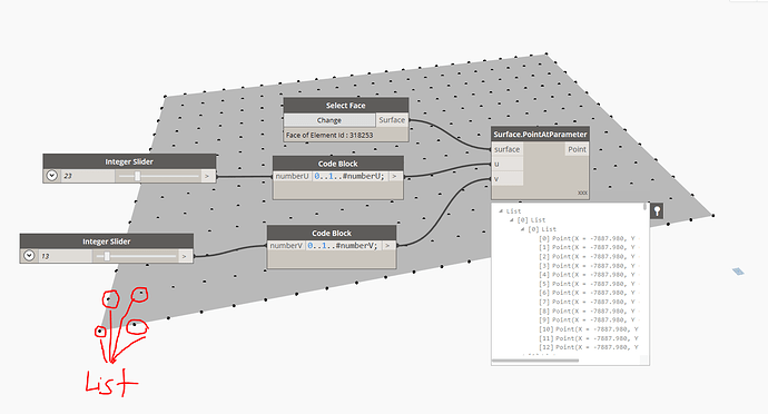

Create a list 4 points
Sorry for my english is not good.
I have created a list of points. Now in I want from the list that filter out the list as shown in Figure 4 points closer together. Adaptive purpose to load family.

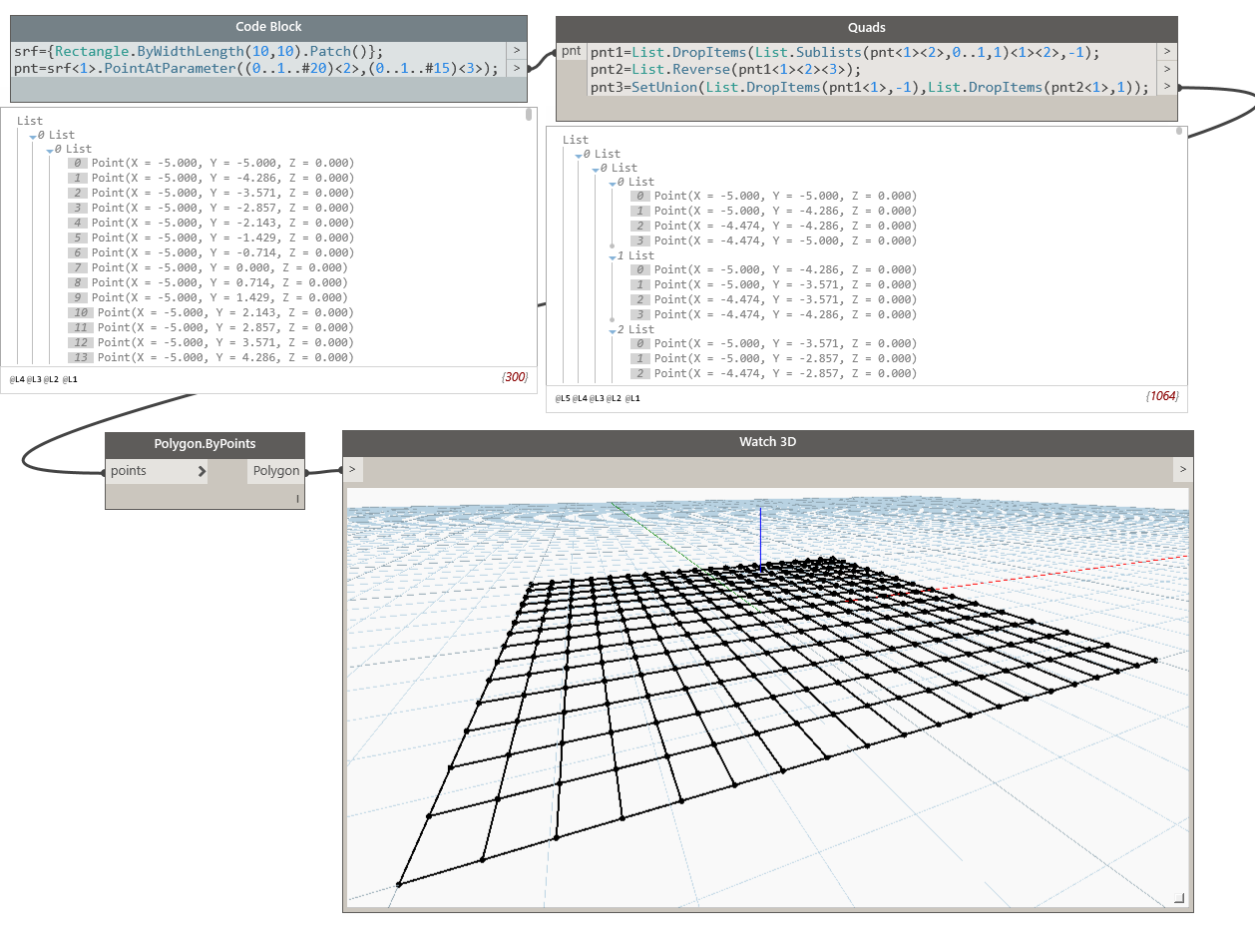

//Quads
pnt1=List.DropItems(List.Sublists(pnt<1><2>,0..1,1)<1><2>,-1);
pnt2=List.Reverse(pnt1<1><2><3>);
pnt3=SetUnion(List.DropItems(pnt1<1>,-1),List.DropItems(pnt2<1>,1));
