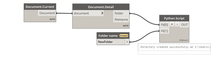

A little Python should do the trick. This will throw an exception if the folder already exists.
import os
def create_folder(path, folderName):
if path is None or folderName is None:
return
fullPath = path + "\\" + folderName
os.mkdir(fullPath)
return "Directory created successfully at " + fullPath
OUT = create_folder(IN[0], IN[1])
The Reply is much appreciated, but… I do not know python… does that replace everything in the Python Script that comes up when you insert that “Python Script block” and select edit? Or does it get pasted at the end?
I assume I at least have to leave:
import sys
Very cool Nick, I didn’t realize that node would create a new directory if it doesn’t exist.
I know you don’t need this anymore, but to answer the question, you would copy and paste everything verbatim into the Python Script node.

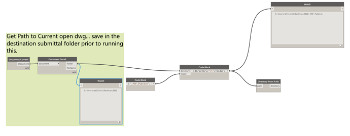

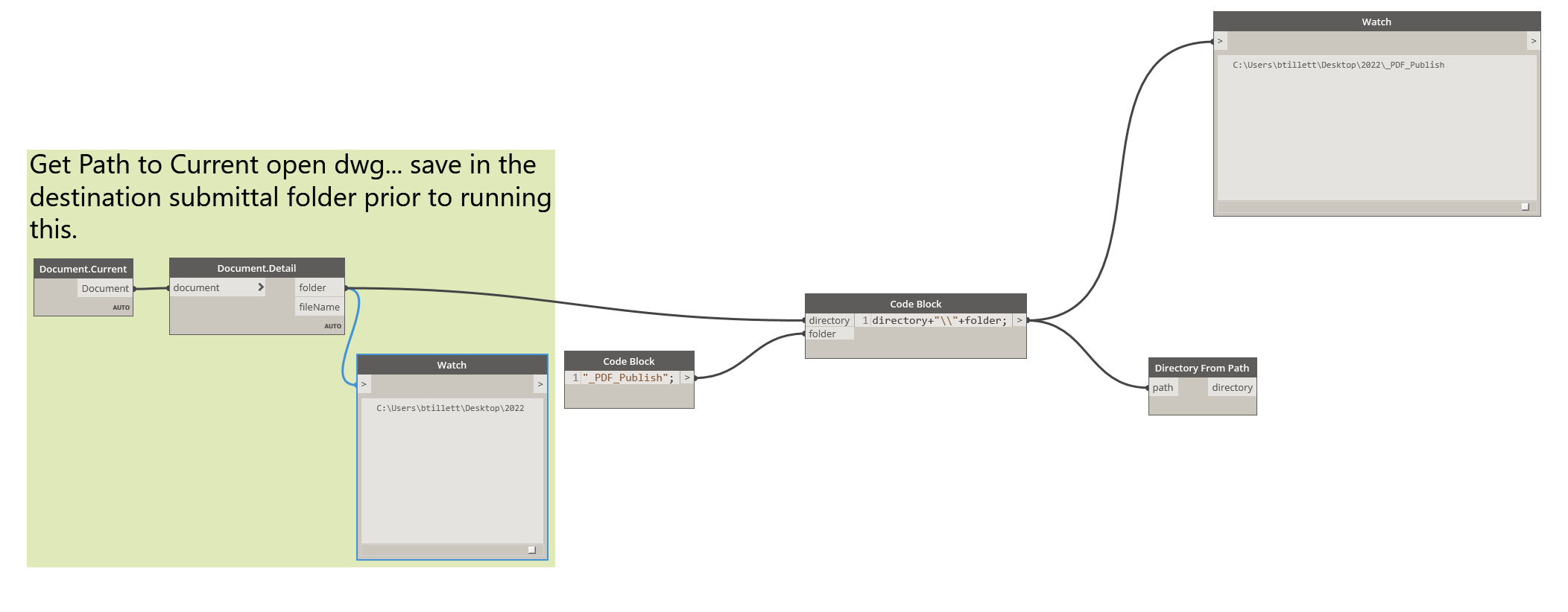

This may be an alternate solution.
