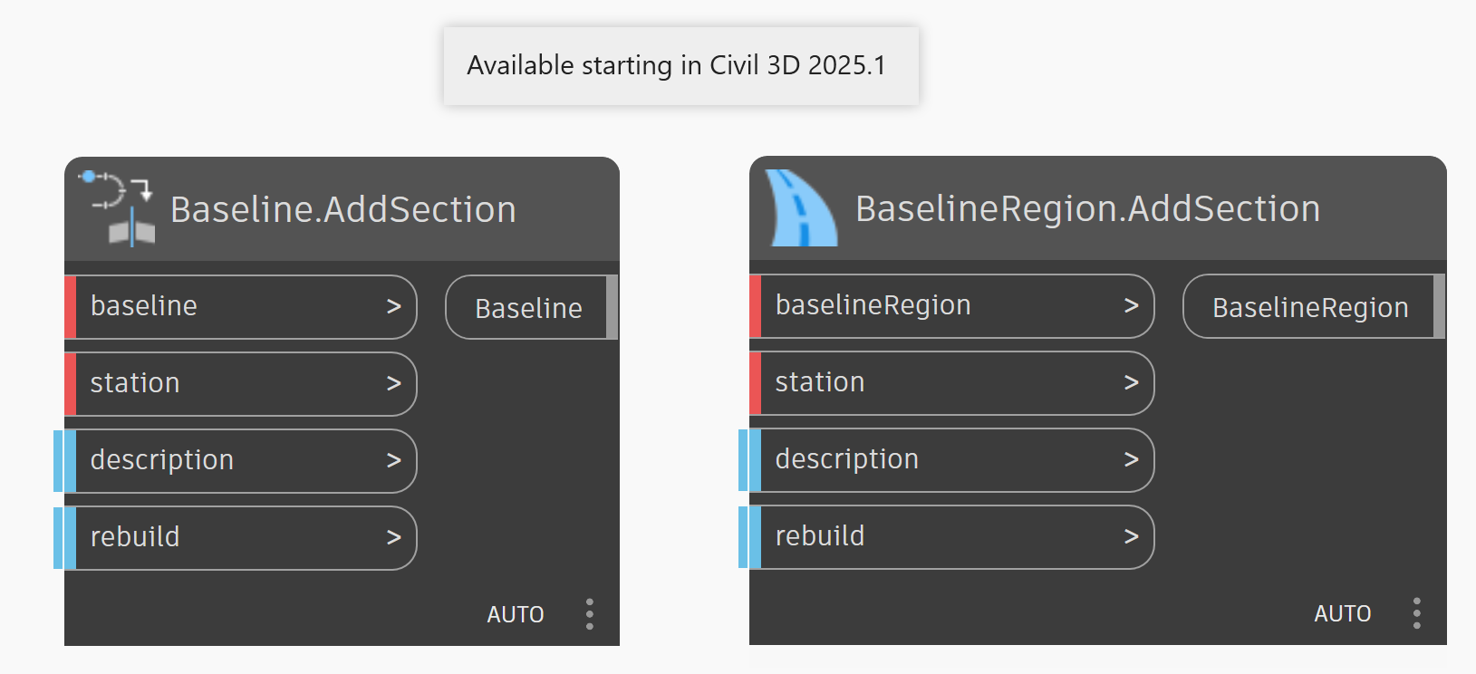

CorridorExtensions.AddStationToCorridor equivalent / alternative?
Since the big update, the old CorridorExtensions.AddStationToCorridor node from the Civil3dToolkit isn’t available. Is there an equivalent or alternative that I might be missing?
Hi @jameshitt,
You can use one of these nodes:
Thanks! I had glanced at them, but I assumed they had something to do with Cross Sections. I should have looked closer.
