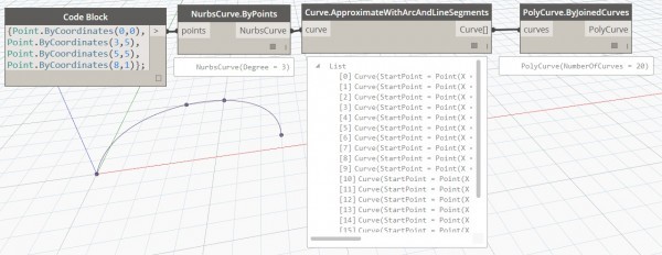

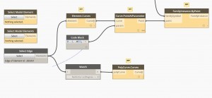

So I know the ‘long’ way of doing this (divide into points, create new curve from points), but is there a super quick and simple method of converting a Nurbscurve into a Polycurve? More looking for a node similar in scope to ‘Element.Curves’.
Example show below:
Nurbs to Polycurve

You are a hero sir. Many thanks.
