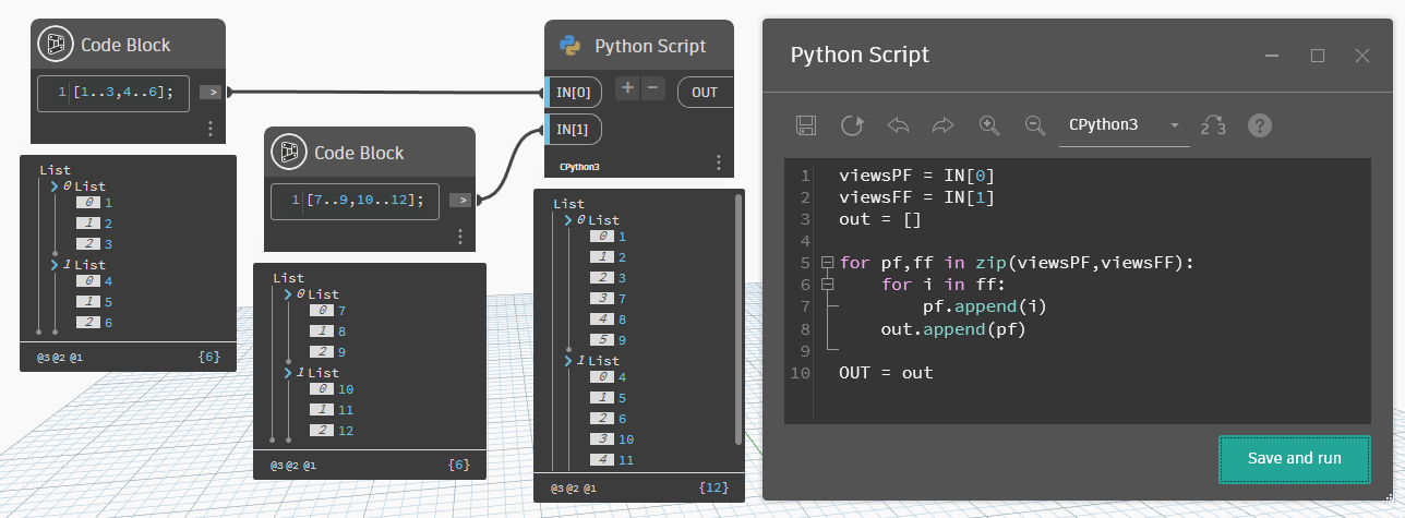

The other option is to step through each item and add it to the initial sublist.

Does the second option work for you?

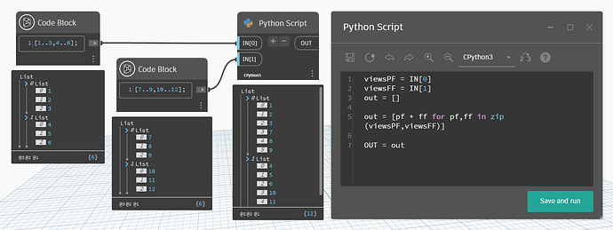

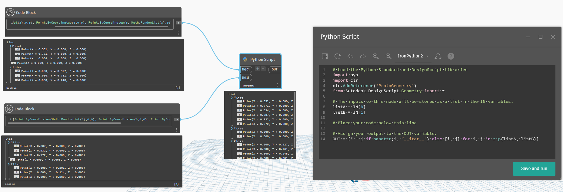

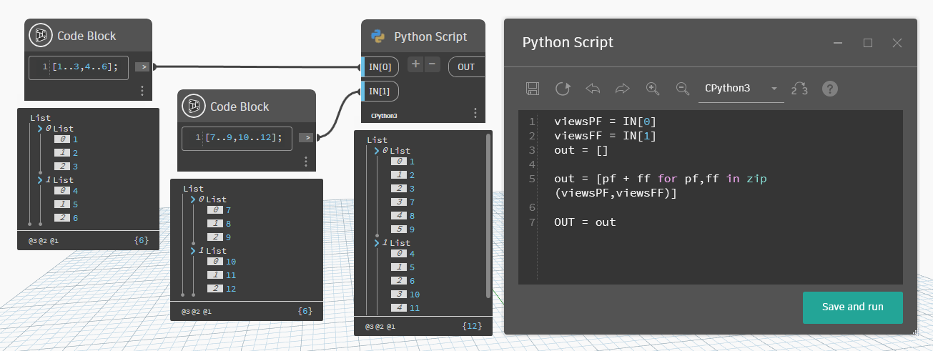

An example
import sys
listA = IN[0]
listB = IN[1]
# Place your code below this line
OUT = [i + j if hasattr(i, "__iter__") else [i, j] for i, j in zip(listA, listB)]

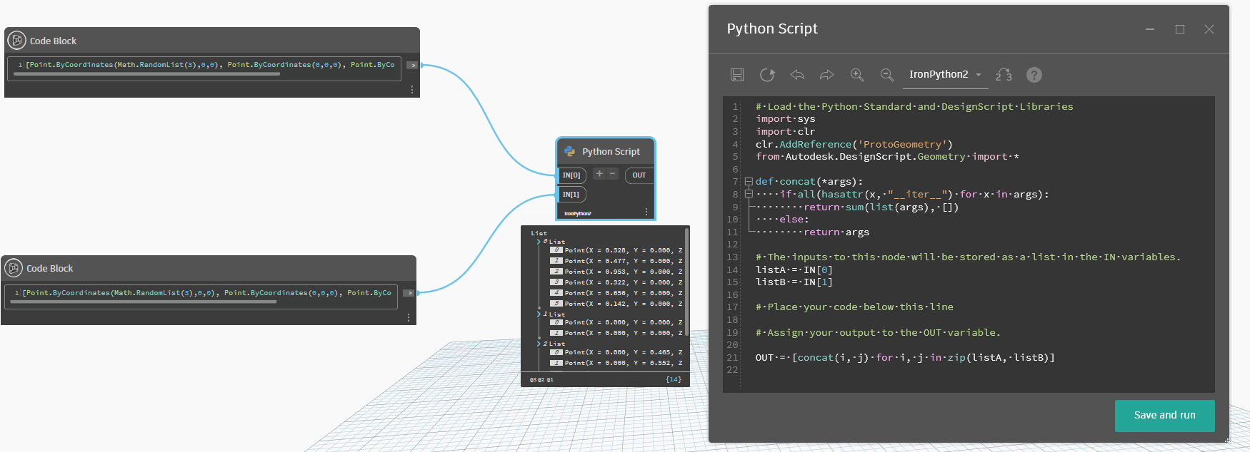

another solution
import sys
def concat(*args):
    if all(hasattr(x, "__iter__") for x in args):
        return sum(list(args), [])
    else:
        return args
listA = IN[0]
listB = IN[1]
OUT = [concat(i, j) for i, j in zip(listA, listB)]
