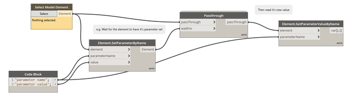

Try something similar to this
Then adapt it to your Python script

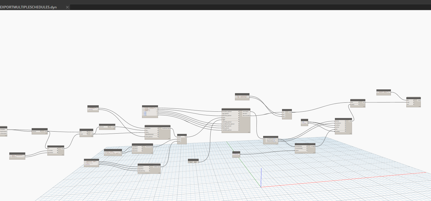

EXPORTMULTIPLESCHEDULES.dyn (55.5 KB)

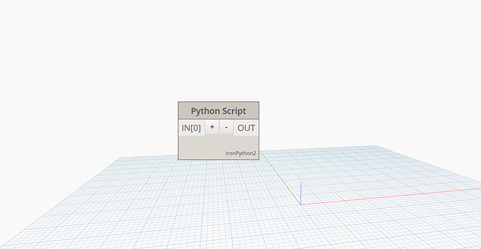

test.dyn (3.1 KB)
these are the files I need to combine. Im working with schedules not parameters

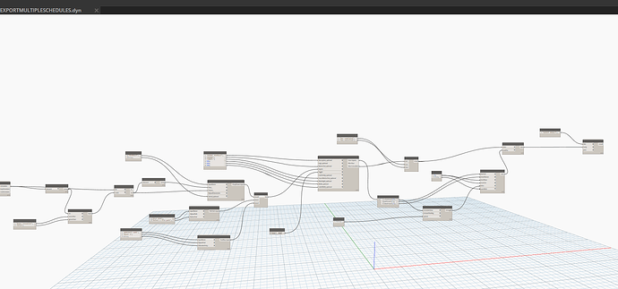

i think my issue is I dont know where to plug this information in so it can work. Im trying this but its not running
so please share an image here that can be read properly, you can use the button symbol of screenshot of Dynamo

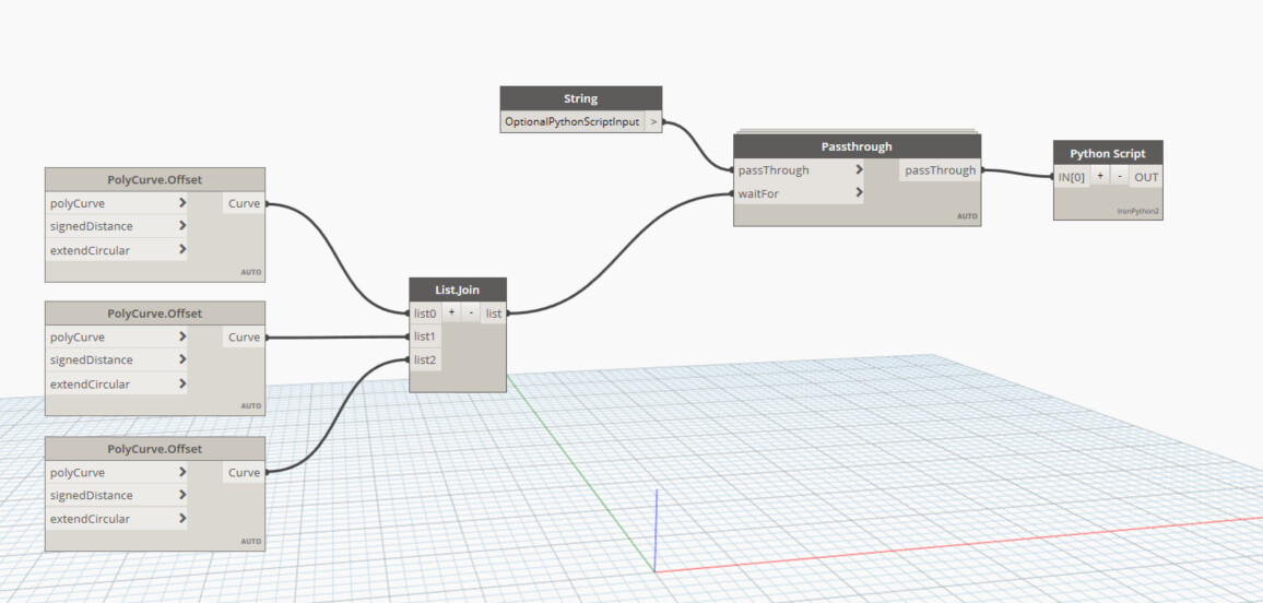

You’ll have to place the Python script after the PassThrough node, like this:
Also, if you have multiple outputs on where you want the script to (force) execute them first, use something like this:
PS: If you have no specific inputs you can just put in whatever you want as input for the Python node. If you have some inputs, just feed them through where the string is now.
