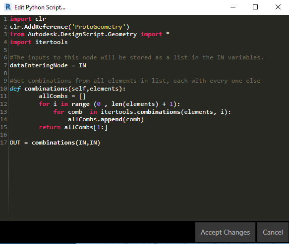

I am currently trying to combine all the elements of a list in order to obtain all the possible combinations:
(a,b,c) -> function = (a,ab,abc,bc,ca)
Which I am trying to do with this code in a python script node:
1
Sadly, when I run it, it’s not combining the elements and just returning the same input.
Any ideas why?
Thanks in advance
right click the node and set lacing to cross product
Wonderful Mr Marcel_Rijsmus! Thanks a lot once again!
