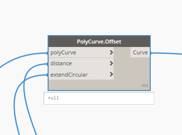

I’m writing code to offset like Polycurve.Offset node in Dynamo.
I want to read code in Polycurve.Offset, Is there any way?

The geometry library for Dynamo is not open source:

Because the geometry library is not open source you can’t read the source code if that is what you want. If it is for writing code in DesignScript or for use within Python in Dynamo then the code to access the node is:
curve1 = PolyCurve.Offset(t1, t2, t3);
where t1, t2, t3 are the inputs
