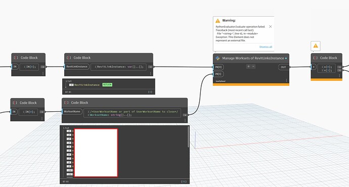

I’m trying to close the worksets of linked models hosted on ACC using the Genius Loci node.
The node returns null but I believe my inputs are correct.
I opened the node to try the python script and got the following error.
What does line 41 and the code reading up to it look like? Note that list strucures may need reworking to make things work in the workspace environment vs the custom node environment.

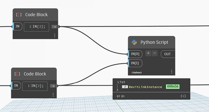

I updated the code in my previous post for a list at input
Thanks for your help, I’m getting a different error now.
Do I need to be an admin on the ACC hub to run this?
try this version :crossed_fingers:

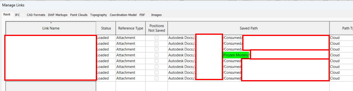

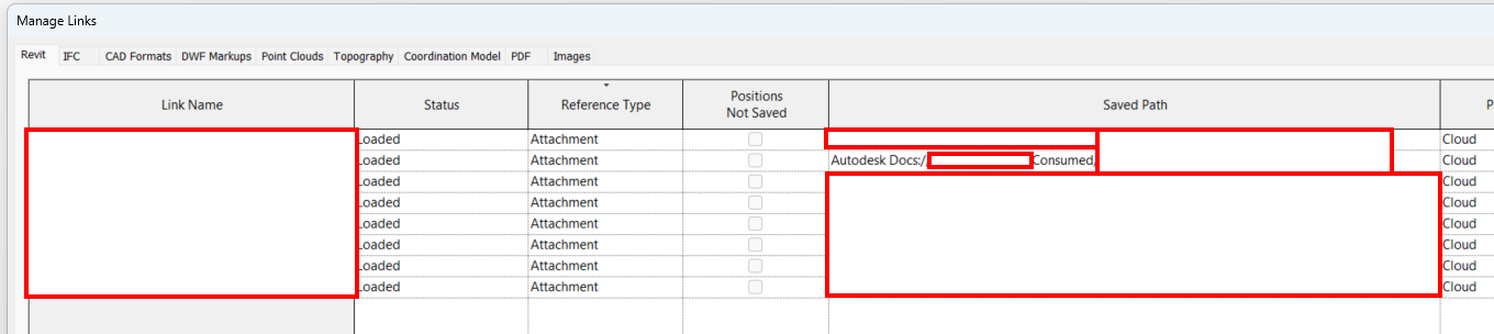

All the models are consumed, then linked in from the consumed folder.
I will try the script on a model that I collaborated to ACC to see if there’s a difference.
It works for a model that I collaborated (highlighted in green), but doesn’t for the models that were consumed.
I don’t know why the models would behave like this since the edit permission is be the same across the folder on ACC. I can double check that there’s not different permissions by default on the consumed folder, but it should inherit the parent folder permissions.
Likely the path is inconsistent for the model types. What are you seeing for those values?
