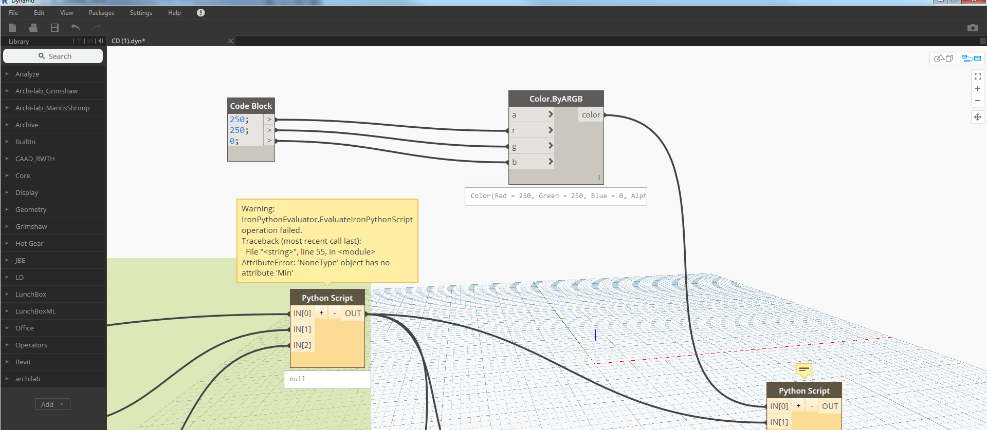

Ive been testing the script along with @Mohammad_Nawar but i am still facing some issues.
First when i run the script i never have the form to chose the current model
This one never shows up.This are the packages ive installed as requested.
This is the first warning that pops up when i run the scrip
“Warning.Get.ValueAtIndex operation failed”
lastly full script with all warnings
I appreciate all help possible! I can also upload the script created by @Mohammad_Nawar

Missing the VERY old version of the archilab package. You’ll want to use the out of the box node instead.
will you please give the soln what i do for this? i’m newbie in dynamo.
Try this or searching your library for ‘by unique’ and you should get some progress.
thank’s, it works
That is a bigger lift. Try switching to IronPython2 engine by installing the right version of the IronPython2 package and changing the engine.
