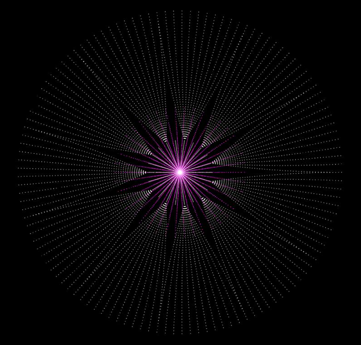

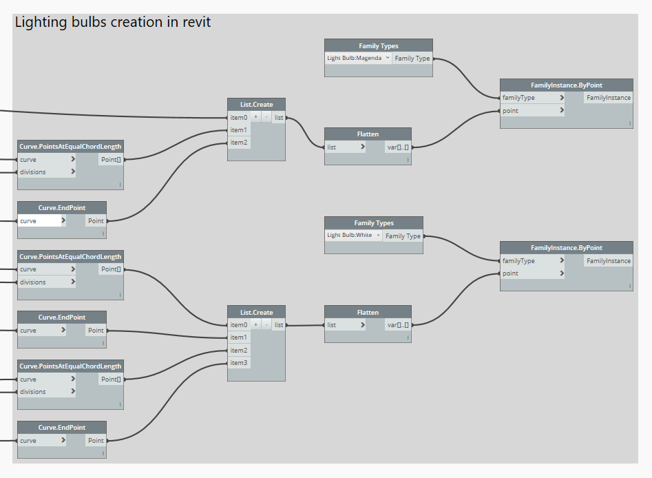

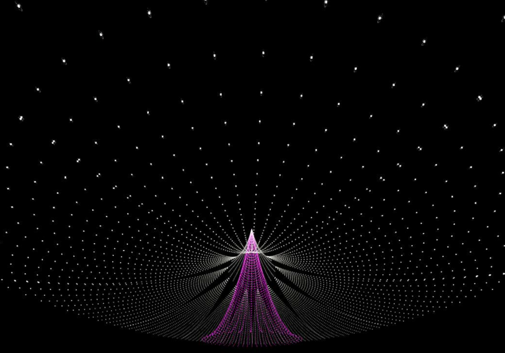

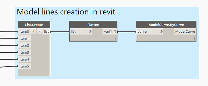

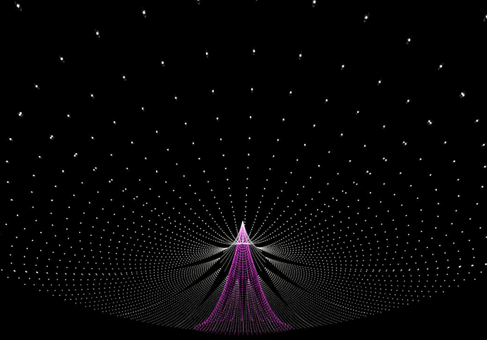

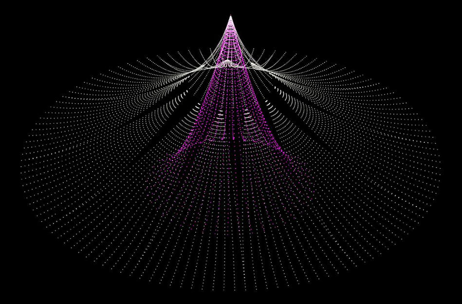

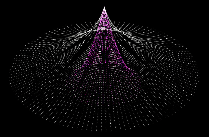

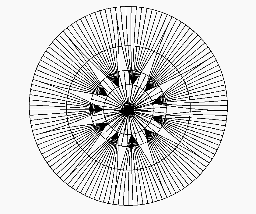

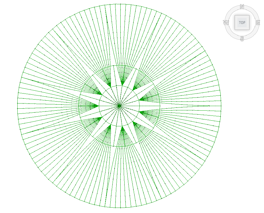

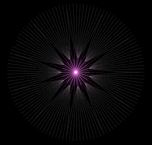

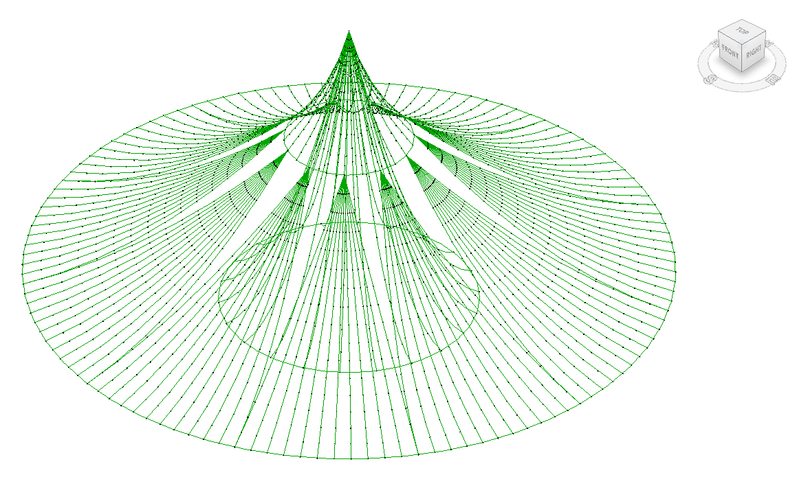

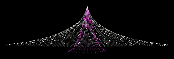

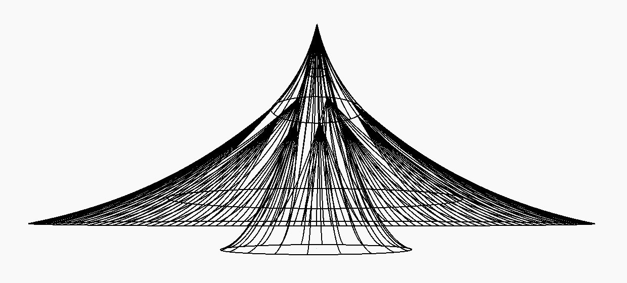

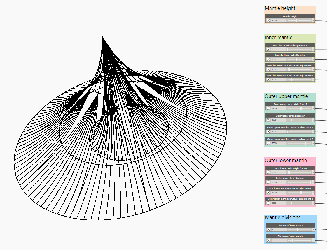

Here is a simple dynamo script for creation of stylish Christmas tree mantle. Basically, it’s just curves (in Dynamo divided by points) which can be transferred to Revit as model lines and be decorated with some custom lighting bulb family elements.
Dynamo environment:
2pic
3pic
Main body of the script:
Revit model lines creation part from the script:
Revit lighting bulbs creation part from the script:
Revit environment:

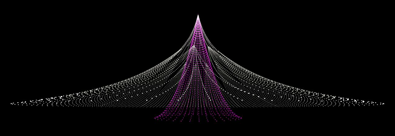

Revit renders for better visualization:
Dynamo script and Revit light bulb family files:

How did you setup up the render?
