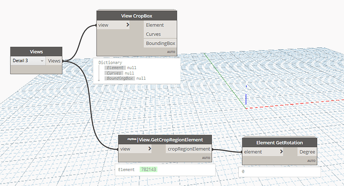

Thnx alban, it works well for Plan views, But not callouts and sections views.
is the Rhytm node doing the same thing? or is it different? however im just getting 0 whatever i rotate the crop region
Hey,
I also did a test and you are right, it doesn´t work for me with section views neither.
But keep in mind, for planviews you have to reset crop to get the right rotation angle if the crop box lines are not horizontal/vertical.
please see
