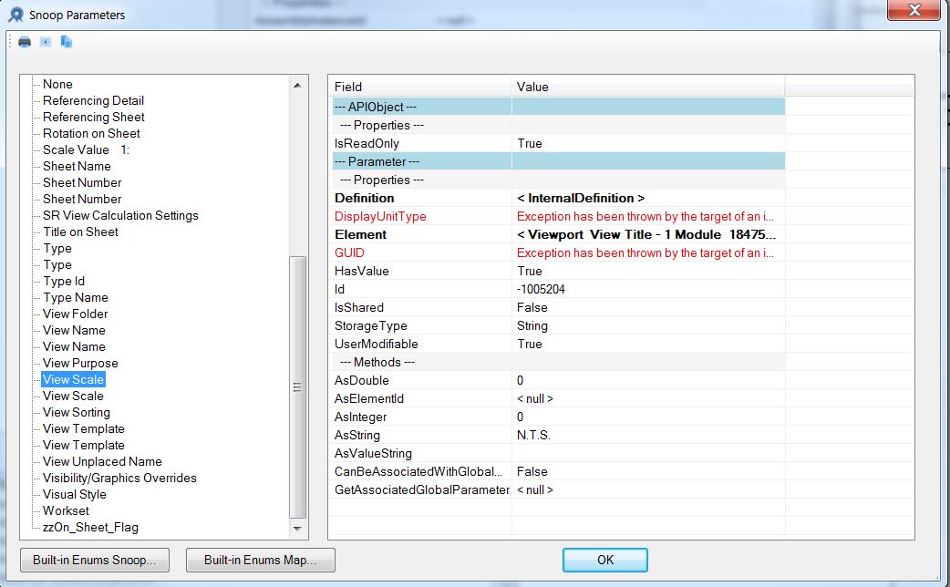

Is it possible to active and set the scale display name? Don’t know why Revit lookup indicated the parameter is read only while the value can be modify manually.

I found this using the button on the bottom left of Revit Lookup, built In Enums snoop

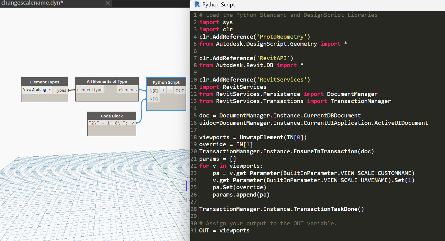

Hey, I needed to change the display name for approx. 300 drafting views today and this is what worked for me:
