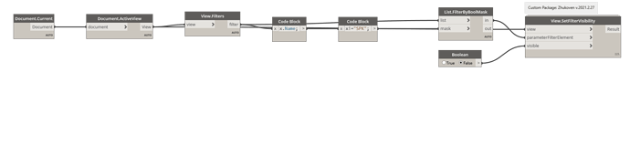

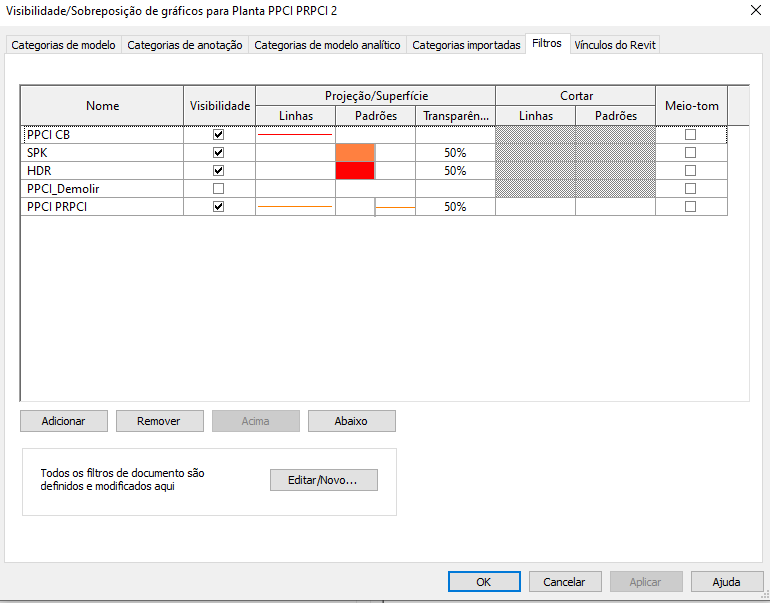

How do I turn the filters ON and OFF?
And how would you determine only the SPK turned on and the others turned off?

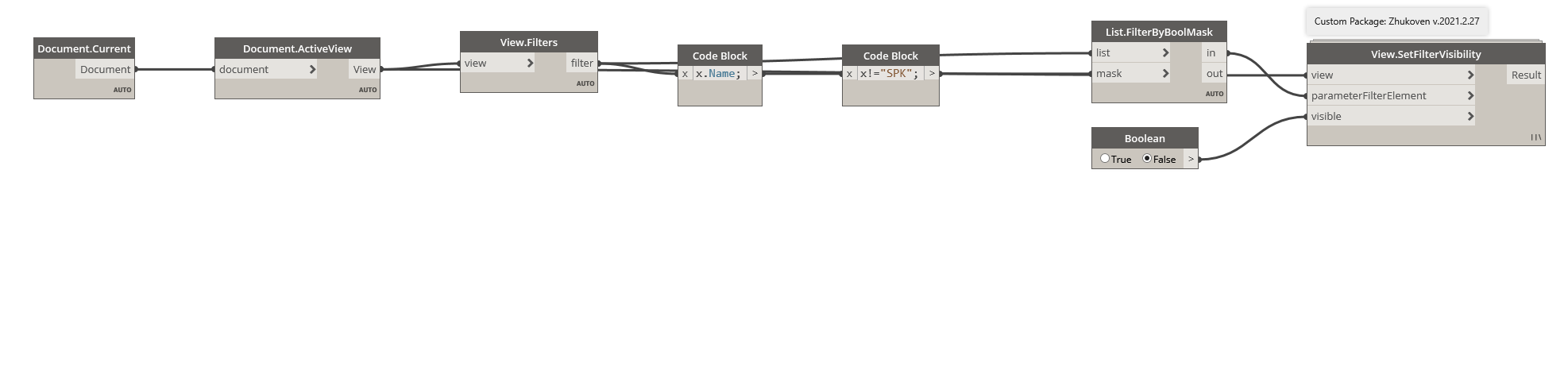

@guilherme.woltmann You will have to install the Zhukoven package. Try this:
SetFilterVisibility.dyn (13.3 KB)
Is it possible to change the order of these filters? Pass the SPK to the top so that it overlaps others?
@guilherme.woltmann I’m not sure about it. I’ll have to give it a try.
Please open a new topic and see if anyone has an answer for that!
Yes would love to do that…but it seems it will always come as you made them. but perhaps a solution where we export them and sort them and back again… but as @AmolShah say lets open new topic, where we can discuss that
