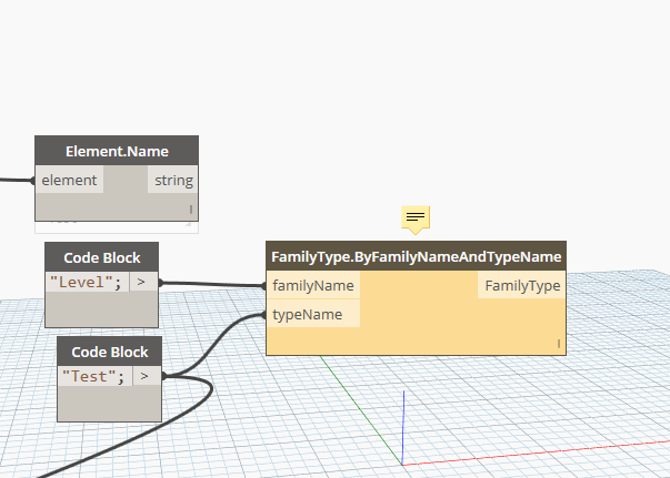

i am failing to change a levels type!

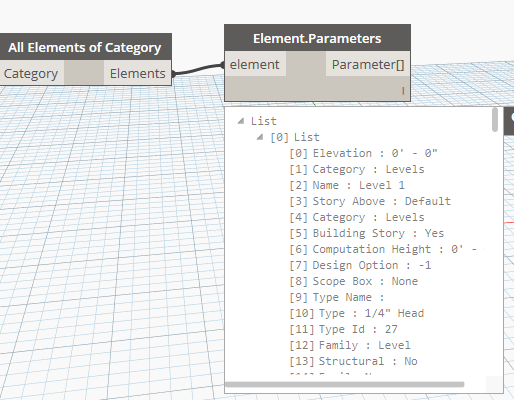

the family = Level the Type = 1/4" Head i created another Type called Test
according to Element.Parameters that should be correct. now i try to change the type from 1/4"Head to Test and fail: the error message is: Warning: FamilyType.ByFamilyNameAndTypeName operation failed. A family with the specified name, Level, could not be found in the document. any suggestions / experiences

why? not supported by api?
because manually it is easy!
Peter,
You should be able to do this by using Element.SetParameterByName node and feeding in the element for the family type into the value. I do not think this is the work flow you are looking for, but I hope you get the idea.
