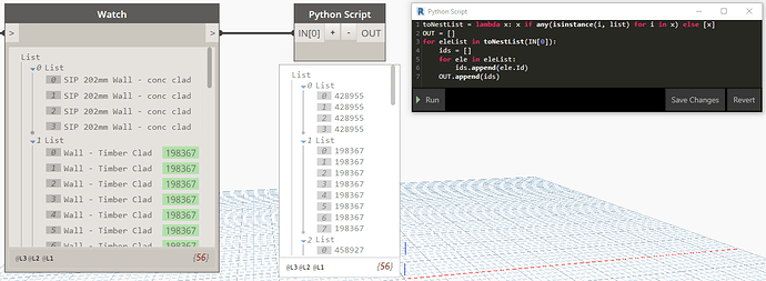

Hi, I would like to get the Id of elements in nested list
So far, I can get Id of elements in normal list, but not success in nested list
is there any way to achieve that?

@hctungBHP7B You need 2 for loops instead of 1. Try this:
Using list comprehension
toNestList = lambda x: x if any(isinstance(i, list) for i in x) else [x]
OUT = [[ele.Id for ele in eleList] for eleList in toNestList(IN[0])]
OR
Using nested for loop
OUT = []
for eleList in toNestList(IN[0]):
ids = []
for ele in eleList:
ids.append(ele.Id)
OUT.append(ids)
@AmolShah Thank you so much that your quick reply and good answer
This two answer are very helpful to me.
But I have some question want to ask.
why does your code can deal with both normal list and nested list well.
Is the key at first line in your code?
Could you explain a little bit??
Thanks so much
Yes, you guessed it right. The 1st line of code makes sure that the list (x) we are inputting is a nested list. If it’s not a nested list then it will make it one by using [x].
Check this out for more info: Python check if a list is nested or not - Stack Overflow

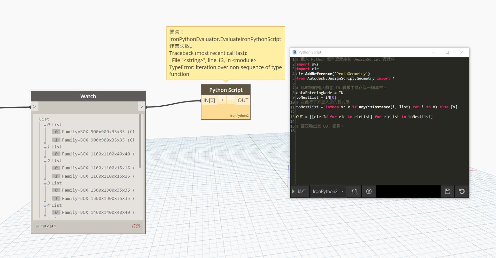

Hi @AmolShah
I also want to ask that why you can move the “IN[0]” to last part?
I am trying rewrite your code, so I move the “IN[0]” to beginning in order to figure out, but it showed error, I can’t figure out the process of your code
is it about to the function of lambda??
@hctungBHP7B It’s difficult to explain but you cannot use it like what you have done.
It’s called a lambda function if you want to know more about it.
You can try something as shown below if you want to ditch the concept of lambda functions for now.
if any(isinstance(i,list) for i in IN[0]):
toNestList = IN[0]
else:
toNestList = [IN[0]]
OUT = [[ele.Id for ele in eleList] for eleList in toNestList]
OR
toNestList = IN[0]
if not any(isinstance(i,list) for i in toNestList):
toNestList = [toNestList]
