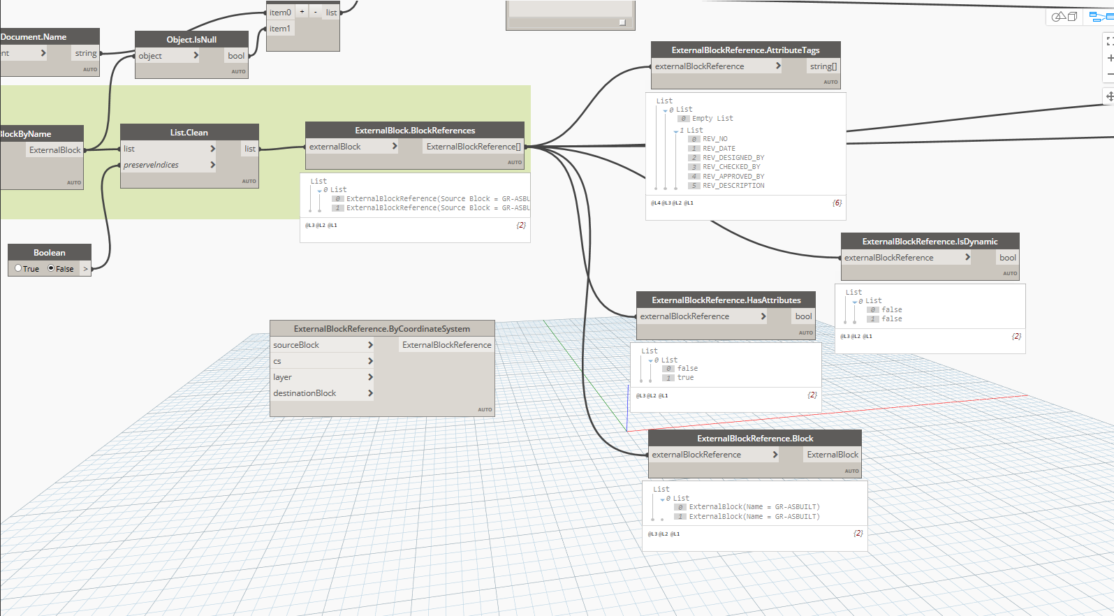

Here are 2 blocks inserted into a drawing, the first was inserted using the “ExternalBlockReference.ByCoordinateSystem” node, and the second was inserted by hand, the attribute checking node says the first block does not have attributes, but it should just as the second does. When I try to edit attributes it throws the error “Warning: ExternalBlockReference.SetAttributeByTag operation failed.
eInvalidOpenState”. How can I make this block have attributes again?
Here is the program that inserts the block:
Try synchronizing attributes with “_.attsync” command after inserting the block
