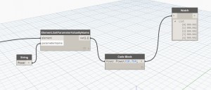

I want to calculate Heating Load with dynamo, but the units is wrong.
I use Watt, but when I have 1 watt in Revit I have 10,746 in Dynamo (some kind of unit)
Then I used dynamo to recalculate the unit in codeblock, but I do not get the exact value.
Picture show where I have 1000 watt, then I godt 999,992 watt in Dynamo. I want the excact value
I do not need the whole script to make the heating load calculation, just the right caculator for the units
