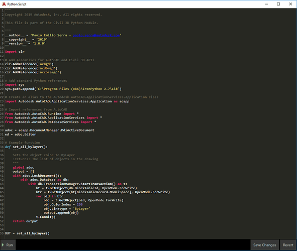

@csanchez you need to set the ColorIndex property to 256 and Linetype to ‘ByLayer’ for all the entities
