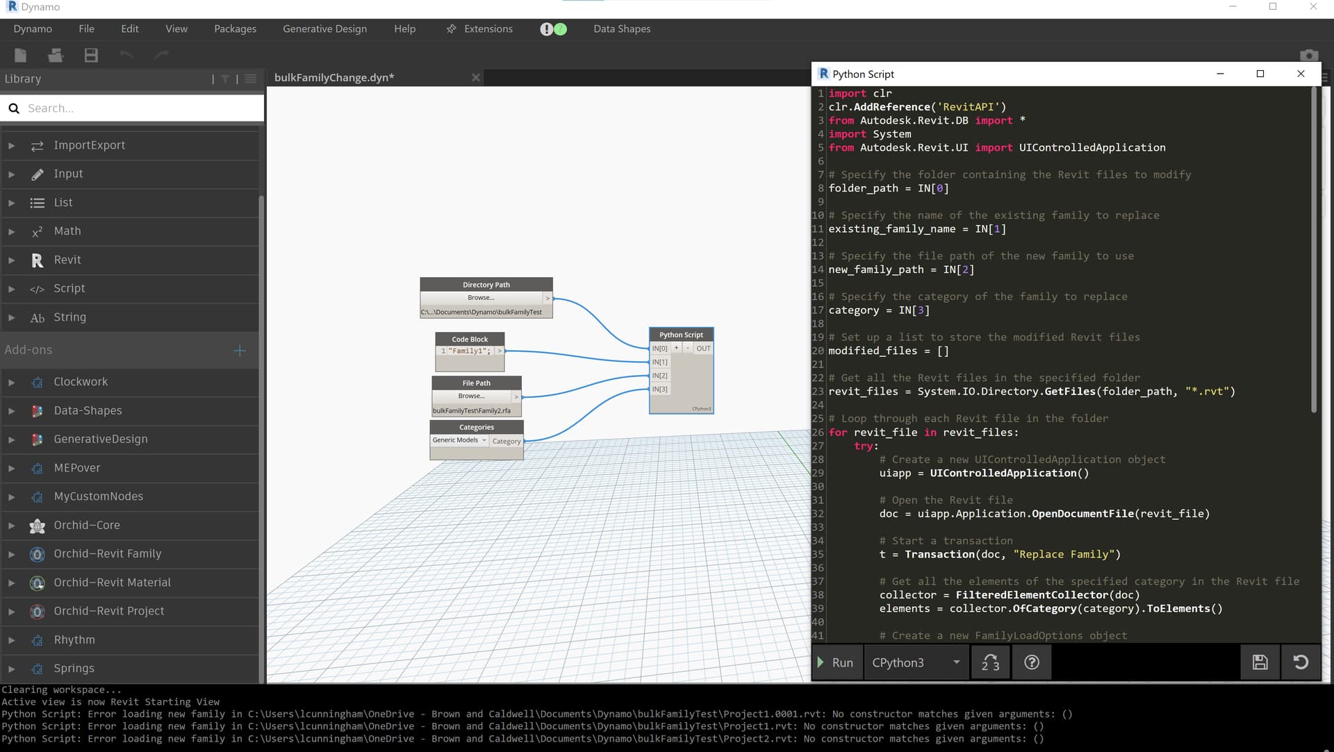

I’m looking to load a family into all .rvts in a directory and replace all existing families of a given name with the new family.
Here is what ChatGPT and I have come up with so far. We are however receiving
Error loading new family in C:\...\Project2.rvt: No constructor matches given arguments: ()
which I find odd because the constructor exists and has for some time, so it must be somewhere else in the process.
Python
clr.AddReference('RevitAPI')
import System
from Autodesk.Revit.UI import UIControlledApplication
# Specify the folder containing the Revit files to modify
folder_path = IN[0]
# Specify the name of the existing family to replace
existing_family_name = IN[1]
# Specify the file path of the new family to use
new_family_path = IN[2]
# Specify the category of the family to replace
category = IN[3]
# Set up a list to store the modified Revit files
modified_files = []
# Get all the Revit files in the specified folder
revit_files = System.IO.Directory.GetFiles(folder_path, "*.rvt")
# Loop through each Revit file in the folder
for revit_file in revit_files:
    try:
        # Create a new UIControlledApplication object
        uiapp = UIControlledApplication()
        # Open the Revit file
        doc = uiapp.Application.OpenDocumentFile(revit_file)
        # Start a transaction
        t = Transaction(doc, "Replace Family")
        # Get all the elements of the specified category in the Revit file
        collector = FilteredElementCollector(doc)
        elements = collector.OfCategory(category).ToElements()
        # Create a new FamilyLoadOptions object
        options = FamilyLoadOptions()
        options.OverwriteExistingFamily = False
        # Load the new family
        new_family = doc.LoadFamily(new_family_path, options)
        # Loop through each element in the Revit file
        for element in elements:
            # Check if the element's family name matches the existing family name
            if element.Symbol.Family.Name == existing_family_name:
                # Replace the existing family with the new one
                t.Start()
                element.Symbol = new_family[0]
                t.Commit()
        # Close the Revit file
        doc.Close(True)#False)
        # Add the modified Revit file to the list
        modified_files.append(revit_file)
    except Exception as e:
        # Print any errors that occur during the family loading process
        print(f"Error loading new family in {revit_file}: {e}")
# Output the list of modified Revit files
OUT = modified_files

For a 1:1 this should get you started. Even if it fully executes what you need I I recommend you review the code and documentation closely as there are several very useful aspects of the Revit API exposed in a way which is VERY useful to know how to utilize for similar tasks. As always if ‘why’ something was done, ask and I’ll try to clarify.
It’s not all roses though - there are a few things to be cautious of before you get started:
  1. This code filters out any file with more than one decimal place in the file path (meaning there is a decimal other than the one which indicates the extension). If you have a decimal point in your file path you’ll need to modify the file filtering.
  2. This code doesn’t take into account worksharing, which is likely the aspect which will give you the most headaches. Look closely into that aspect of document modification (what if someone else owns one of the elements? how do you sync? etc.) before attempting this in a real project.
  3. This code also doesn’t account for your project environment (ie: ACC, BIM360, Revit Server, local network, detached files, etc.).
  4. I didn’t bother with the category filter - assuming your family name would be unique across categories.
  5. It assumes that all types under the previous family want to be the new family type created by loading the family into the project, and that you’re only loading one family into the project. If this isn’t the case (likely on projects of scale) I recommend taking a break and consider how you’ll map the type options; if there isn’t a 1:1 method then you can still load the family into the document, but someone will have to open each file and make the swap (select the instances via the project browser).
