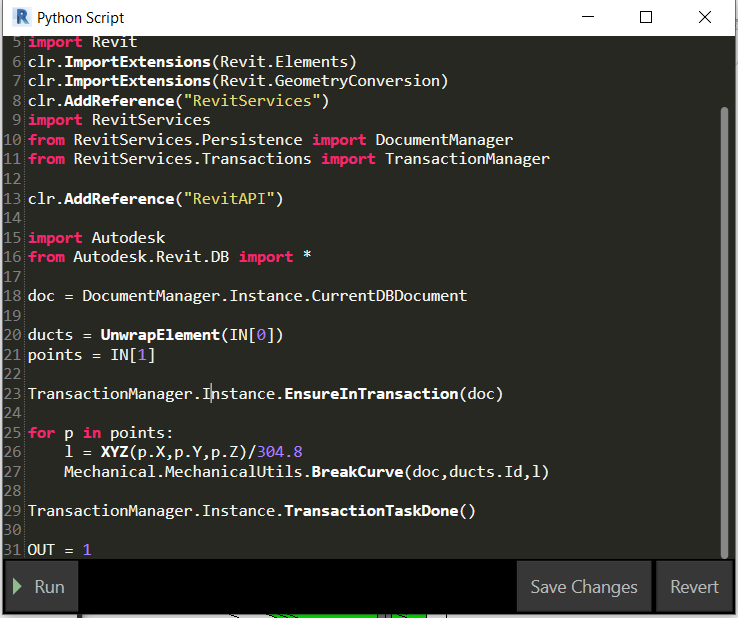

hello! I want to split duct at mutli points below at walls:
my script:
the script is OK if only one point, but if mutli points, the ducts have have new element ID so that it cannot be splitted with the original element ID.
oh I found the solution suddenly
