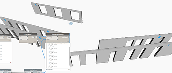

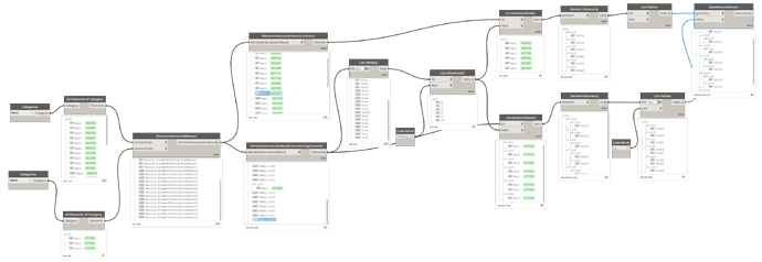

Im trying to create a script that starts by checking the clashes between ducts and walls; im currently here:

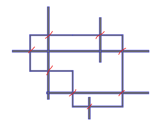

and the plan is:
as you can see in the script there are 12 points, but in the plan as you can see there should be 8!
where did the 4 come from? is there a fault in the scripts logic?

The List.AllIndicesOf and List.GetItemAtindex are very slow, when number of input elements grows. FilterByBoolMask will be much faster.
I will try to retain your feedback (thanks for the information :+1:)
cordially
christian.stan
AH! I see
so the “ElementIntersectionResult.IntersectingElements” and “ElementIntersectionResult.Element” give all the elements from the intersecting category, I need to filter only the items that are intersecting, this is why you used “List.AllIndicesOf” and “List.GetItemAtindex”
Clear! Thank you so much
as for your comment, I believe this is what you meant:
thank you so much!
