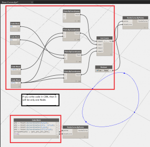

Bean Curve
In the attachment, I have created 4 points & joined them with a nurb.
But is there a faster way to create this curve, by writing a formula in the code block?
Thanks.
Hello Chander Gupta,
As your Points are having some specific Coordinates , you have to create them and then make it a collection.
There is one way to minimize Number of Node usage to write some simple code in CBN. (See attached image).
Thanks,
Ritesh

Hi Ritesh,
The ‘arrayOfPoints’ doesn’t seem to be working…any idea on this?
Thanks,
Chander.
Hello
arrayOfPoints is not working because you have added those points which is wrong, you need to separate them by comma.
arrayOfPoints = {pt1+pt2+pt3+pt4}; (wrong)
arrayOfPoints = {pt1, pt2, pt3, pt4};
Thanks,
Ritesh
