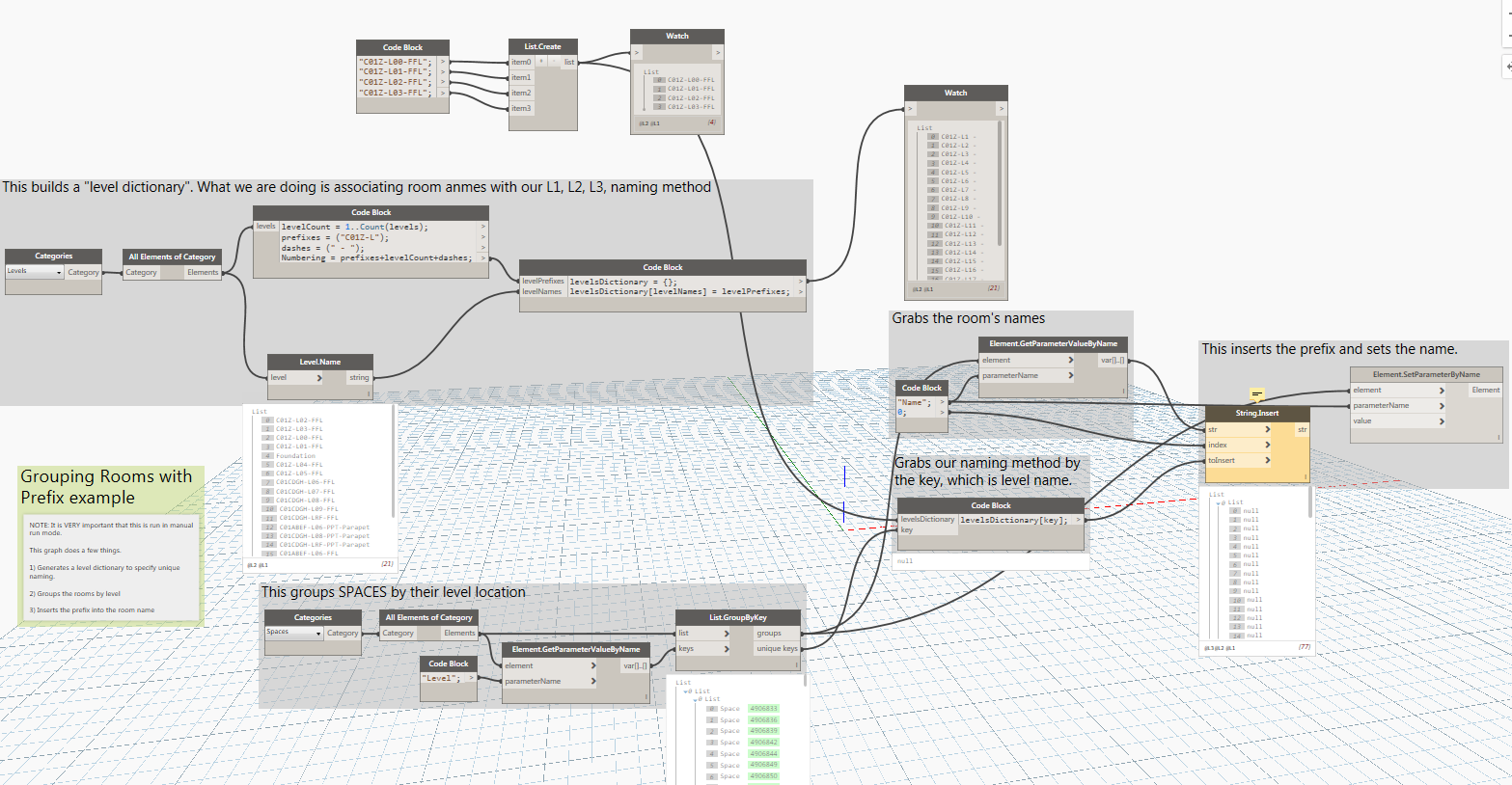

Well thankfully we can account for that! Here is an example using dictionaries to create the specified prefixes. Dictionaries are fairly high level, but they will achieve what you want. This example should get you most of the way there. You will have to adapt to your workflow though.
and here is the graph.
groupingRoomsWithPrefixes.dyn (15.0 KB)

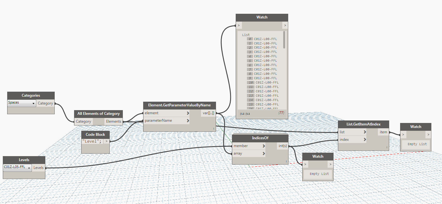

I am very bad with list management / matching, so I used a custom node (IndicesOf) I found online: http://plevit1.blogspot.co.uk/p/enjoy.html
However, it returns an empty list…
Use group by key in my example above.
