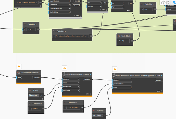

Hello, I was trying to do some tests on the script but this time inserting windows and I wanted to implement it with some nodes that give me the possibility by inserting an input in the choice of the Sill Height of the window. I tried to insert these but it gives me error, in fact they do not undergo variation in height but always remain at the level of the level. Where am I wrong? Thank you
