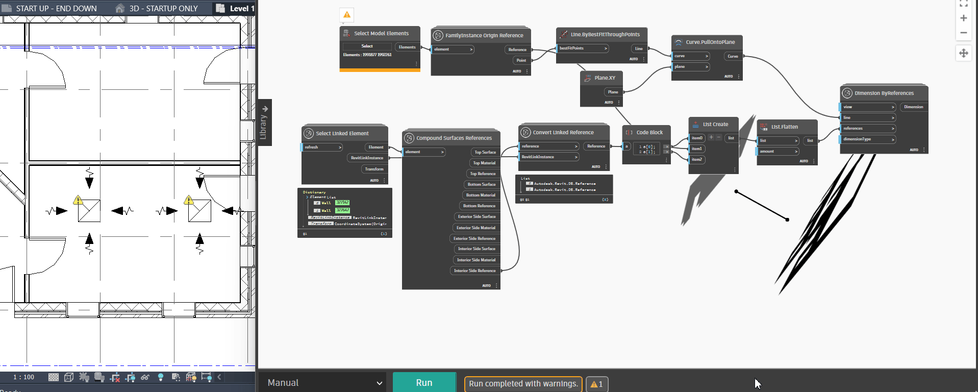

i am trying to create dimensions from wall to lighting fixtures, the code looks good but the dimensions did not appear. please help me.

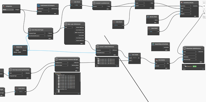

Hi @thsa2501 guees you will need convert your reference for linked walls, genius have a node for that as well
¨Hi i cant help you as you dont have shared a rvt link for try on…but try pull you line on plane, here an example with airterminals

i followed your code,and nothing happened.

allright is it something here ?
hi sovitek,
sorry for the late reply.now its works .thank you so much ![]()
