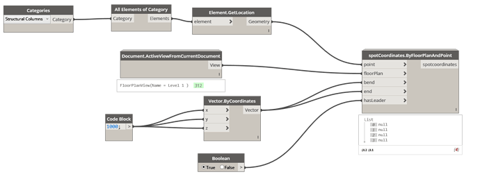

I have created script for auto spot dimensions in Dynamo 2.0.1 and trying to recreate in Dynamo1.3.2 version for those who have earlier version. The script is working in 2.0.1. But the one which I created in 1.3.2 is not working. Guidance requested.
Auto Spot Dimensions for Structural Columns 2.0.1.dyn (12.9 KB)
Auto Spot Dimensions for Structural Columns.dyn (6.5 KB)
If the only difference is the last node, it make be some content in this custom node which isn’t working correctly.
If not, try opening the custom node up and pasting the contents into the active workspace to identify where the flaw is. It may be as simple as a missing 1.x compliant version of a dependent package.
Hi. I am not clear what you are suggesting. By the way I created the spot coordinates node from spotlevel nodes from clockwork as suggested in Spot coordinates
. So it is not that I copied some script from dynamo 2.0 to 1.3.
