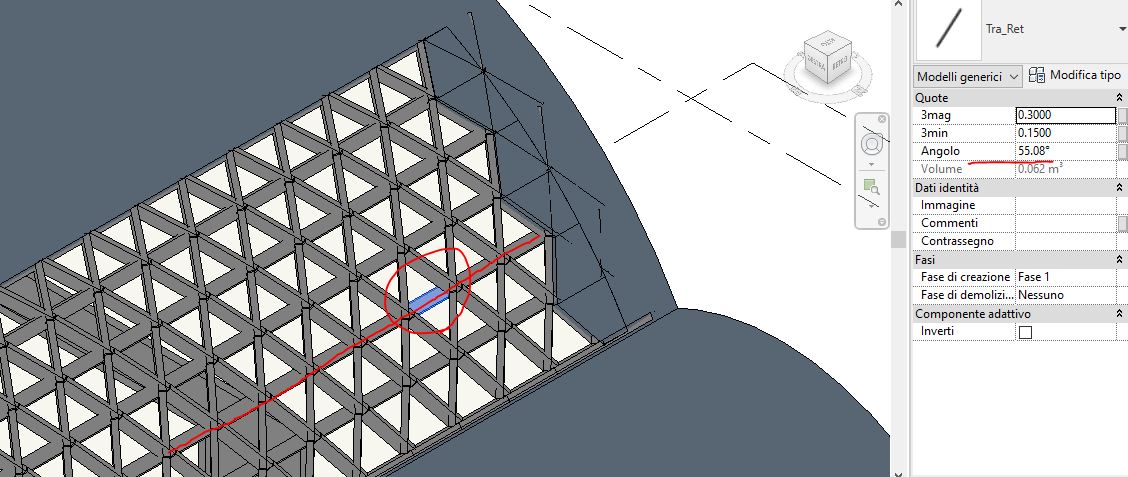

I have these horizontal mullions (traverses), subdivided by rows.
Each mullion has an angle parameter, and each row should have the same inclination angle.
So I Have 7 rows and 7 different angle values, how can I set this parameter for each different row?
