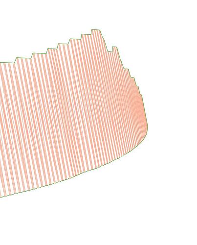

this is how it looks like and it called tin surface in Civil 3d

I don’t want to annoy you for long, but importing the points worked perfectly. I only have an issue with the TIN surface. Here’s a quick screenshot of my Dynamo, this is the current status, and below you can see ‘surface,’ but I can’t make any more progress. i have no idea :se
