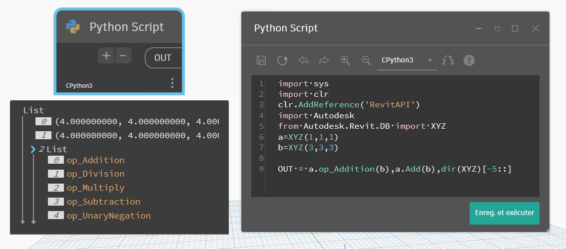

Hello I am trying to add vectors (XYZ) in my dynamo nodes and it seems all the operations with(+, -, *, etc.) are not working.
the following shows error with subtraction.
I am working on Revit 2025.2 Dynamo 3.2.1

CPython3(Pythonnet2.5) do not support Operators .Net
Solutions :
or
  • use PythonNet3 engine (via PackageManager) which fixes this problem and others

Were the guys who wrote CPython the ones who transcribed the operators? There are five with the op prefix.
Thanks.
Sincerely,
Christian.stan
op_ methods (like get_ methods) are generated when compiling the dll (Revit API).
PythonNet2.x alias CPython3 does not support the transcription of op_ methods to python methods __add__, __sub__, etc…
