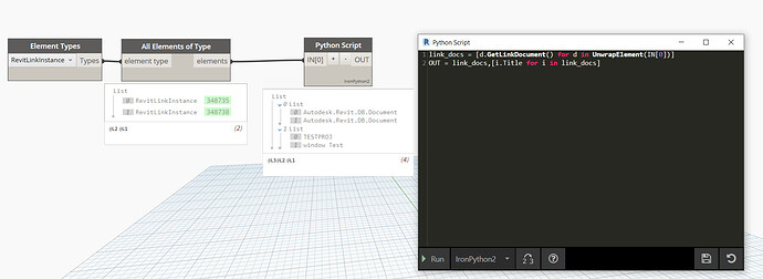

@Draxl_Andreas If your inputs are RevitLinkInstances, then this (2 lines) should work too:
