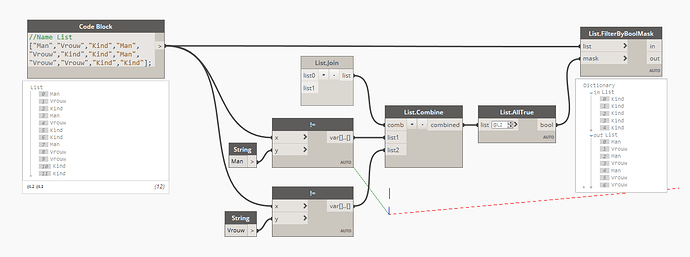

Though, I would now like to add a rule to the filter, exclude yet another workset. The idea would be like this:
I believe some kind of python script must be the easiest way to accomplish this, but that would be way above my knowledge, since Dynamo itself is new to me :). So, If I would like to stick to Dynamo, anyone got an Idea how to filter with multiple conditions?
Thanks,
Edit: Double posted pic.
Python would be completely overkill for this. Look at this!
2019-12-13 Dynamo Forum Post LJac.dyn (15.0 KB)
As you can see this is easily expandable
Easy as that! Made a first try, and it seems to work fine! Thank you so much, appreciate it!
I kinda feel like one of the biggest obstacle while new to Dynamo is to know what commands are available (both as standard in Dynamo and all the packages). I did had in mind that something like that would be available. Thanks again!
