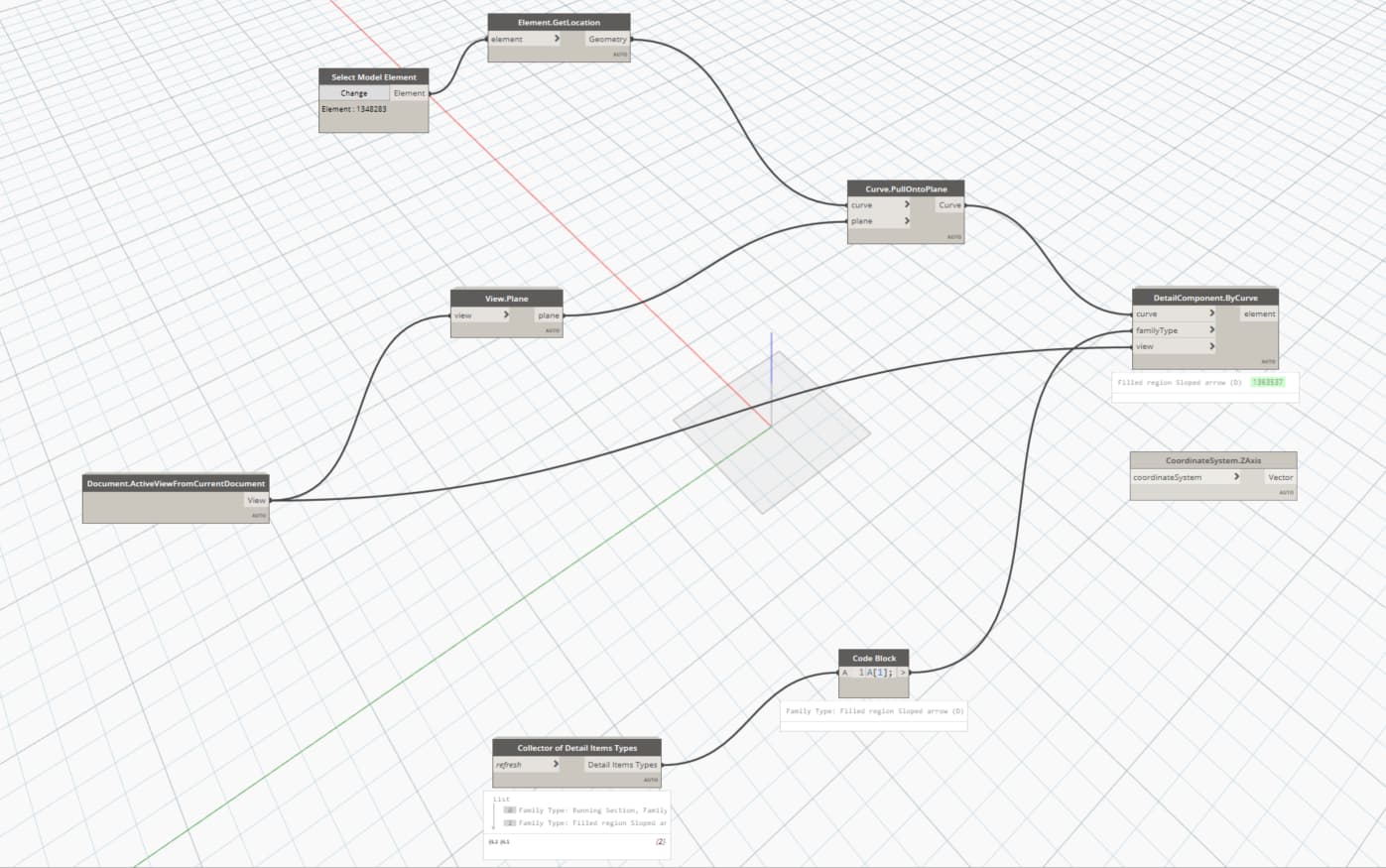

Allign annotation flow arrow along the pipe
Your curve needs to be on the same plane at the view.
Use a View.Plane node (also clockwork) to pull the cut plane of the view. Then pull the curve onto the plane with a Curve.PullontoPlane node. That resulting curve goes into the DetailComponent.ByCurve node.
Yep.It worked
