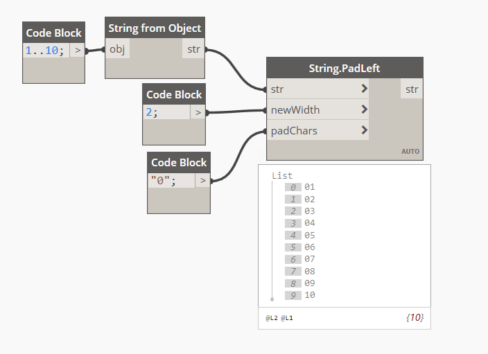

Here is one way:

It’s all about data types. Your parameter is set to be a decimal number (double) and to get the padding you need to convert it to string. The solution is to change the parameters data type to text.
Apologies, I’m a beginner with Dynamo. The Revit parameter is an integer type, can I not change the data type in dynamo?
Not if you need the leading zeros unfortunately…
