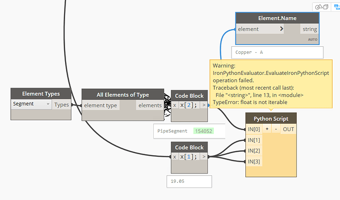

I’m trying to create a python code to add a new sizes for a certain pipe segment, but i get an error of " The float is not iterable" as shown below, Please Advise??

You are providing a single object, not a list, to at least one of the inputs. If you do not want to modify the python code, you can use a List.Create node to ensure that your input will be a list. Otherwise, you can write a function like this and apply it to each input to ensure that each input will be a list:

I tried using list but with no success, I got another error as shown below,

the same error occured, I think the problem is not creating a list
I would add your list of elements to your zip function. The way your script is currently set up, you are trying to modify the list of elements rather than the element itself.

got the error " unknown Element is not iterable" :frowning_face:

finally i got another error of "Expected reference got list"
You are using a list as your argument for the Document.GetElement method. GetElement accepts the following overloads:
String (UniqueId)
ElementId
Reference
However, you already have the elements themselves as your input, so using GetElement isn’t necessary. You need to unwrap the DesignScript elements to use them with the Revit API using the UnwrapElement function as you were doing before. Add “elem” to your zip function and process each pipe segment with its respective measurements.
